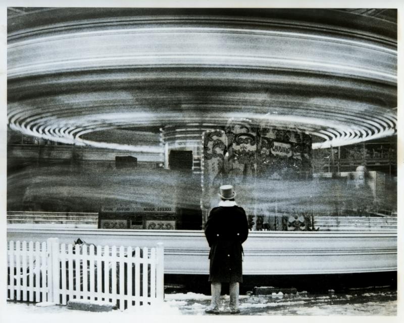

I came upon some Ilford Ilfobrom Rayon (Grades 2 & 3) here in Baltimore. The texture is insane! It feels like linoleum or maybe even more like one of those grip cloths you use to open jars. It looks great 18 inches away but put your face up to it and it looks like halftone dots. I can imagine not liking it for most applications but I was rather pleasantly stunned with how unique the texture is and it turned out great for the subject.
No idea how old it is, appears to be rather old but printed great. Very slight brown tone to the highlights and shadows. One odd thing was how long of an exposure and development it took. Exposure was quite a bit longer than I was expecting and no image appeared until 4 minutes in freshly mixed Dektol and the image didn't stop noticeably developing until after 5 minutes. Is that normal for older papers or something to do with Ilfobrom papers?
Has anyone used this paper before and for what? When did Ilford make it?

I guess it may be 50's or early 60's... I thought I had heard of everything....not this one!
If I recall Rayon was a trade name or somesuch from Imperial Chemical Industries ( the mighty ICI in the UK ) who owned ILFORD at that time and subsequently sold us to Ciba-Geigy of Switzerland.
I have to say you were lucky to get anything to come up....

My experience of old papers is that Ilfobrom, Kodak Bromide and similar bromide papers work remarkably well even when 50 to 60 years old, they lose a lot of speed and about a grade in contrast. I still have a box or two of Ilfobrom from the 60's, I tested it a couple of years ago.
I never saw the Rayon finish but there was something similar in Ilford's early RC papers, I really didn't like the sir face it disappeared quite quickly.

Rough textured papers are useful when you want to de-emphasize detail in the print. At one time a manufacturer like Kodak supplied papers in a dozen or more surfaces. Some were very coarse and had names like tweed, tapestry or canvas. Older editions of the Kodak Darkroom Data Guide contained actual samples of these papers. Sadly must surfaces are no longer made. They could be very effective artistically for certain subjects.
