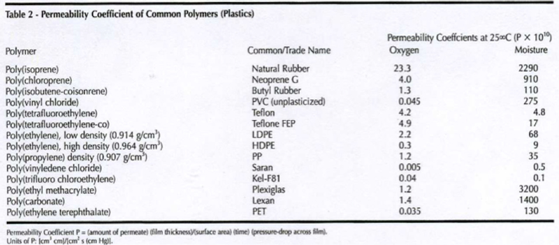

There are very cheap plastics tat have very low Oxygen Permeability Coefficient, see this table:
PET is good but the right PVC kind (unplasticized) is almost as good, and bare Saran ( https://en.wikipedia.org/wiki/Saran_(plastic) ) is extraordinary, with an Oxygen Permeability Coeff. that is 1/8 of the PET one.
It would be really weird if those acordions were not well made, because the right plastic to make them may cost only a few cents. Probably time ago there were bad products with very thin plastic, but the ones we see today should be really good.
Sadly, Saran Wrap isn't what it used to be. Courtesy of Wikipedia:
Formulation change to polyethylene[edit]
Today's Saran Wrap is no longer composed of PVDC in the United States, due to cost, processing difficulties, and environmental concerns with halogenated materials[1], and is now made from polyethylene.[11] However, polyethylene has a higher oxygen permeability, which in turn affects food spoilage prevention. For example, at 23 °C and 95% relative humidity polyvinylidene chloride has an oxygen permeability of 0.6 cm3 μm m−2 d−1 kPa−1 while low-density polyethylene under the same conditions has an oxygen permeability of 2000 cm3 μm m−2 d−1 kPa−1.[12] For that reason, packaging for the meat industry still may use PVDC containing films, as a barrier layer.[13]
