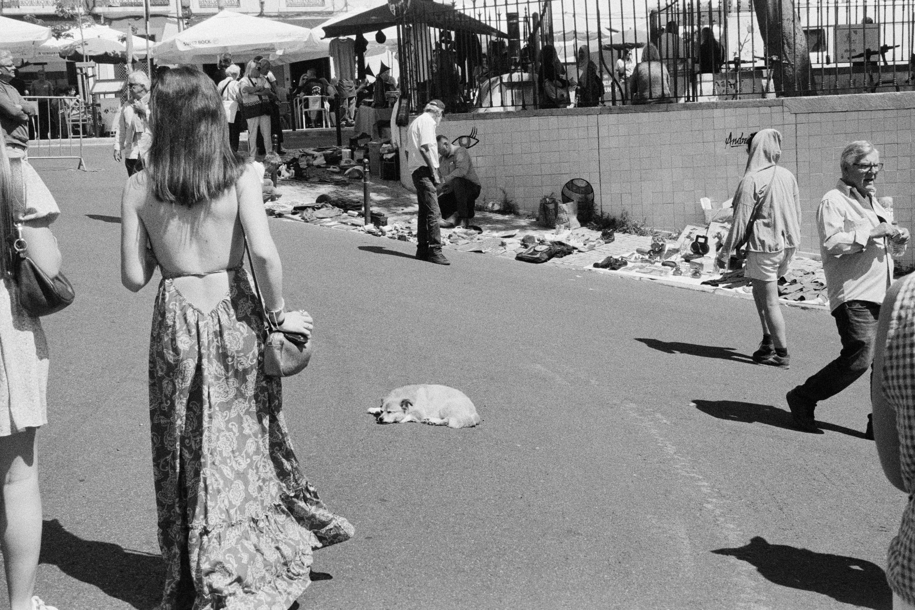

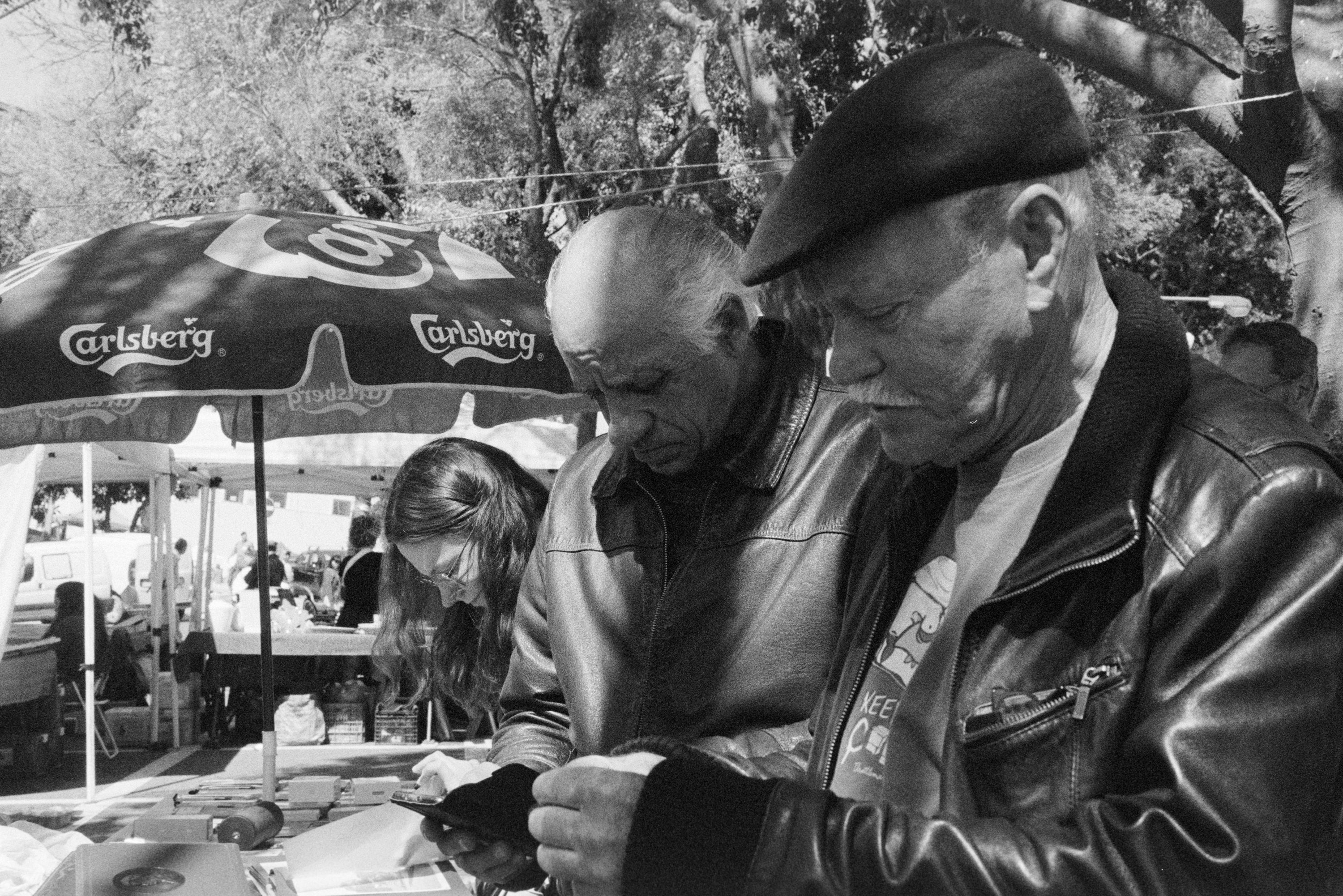

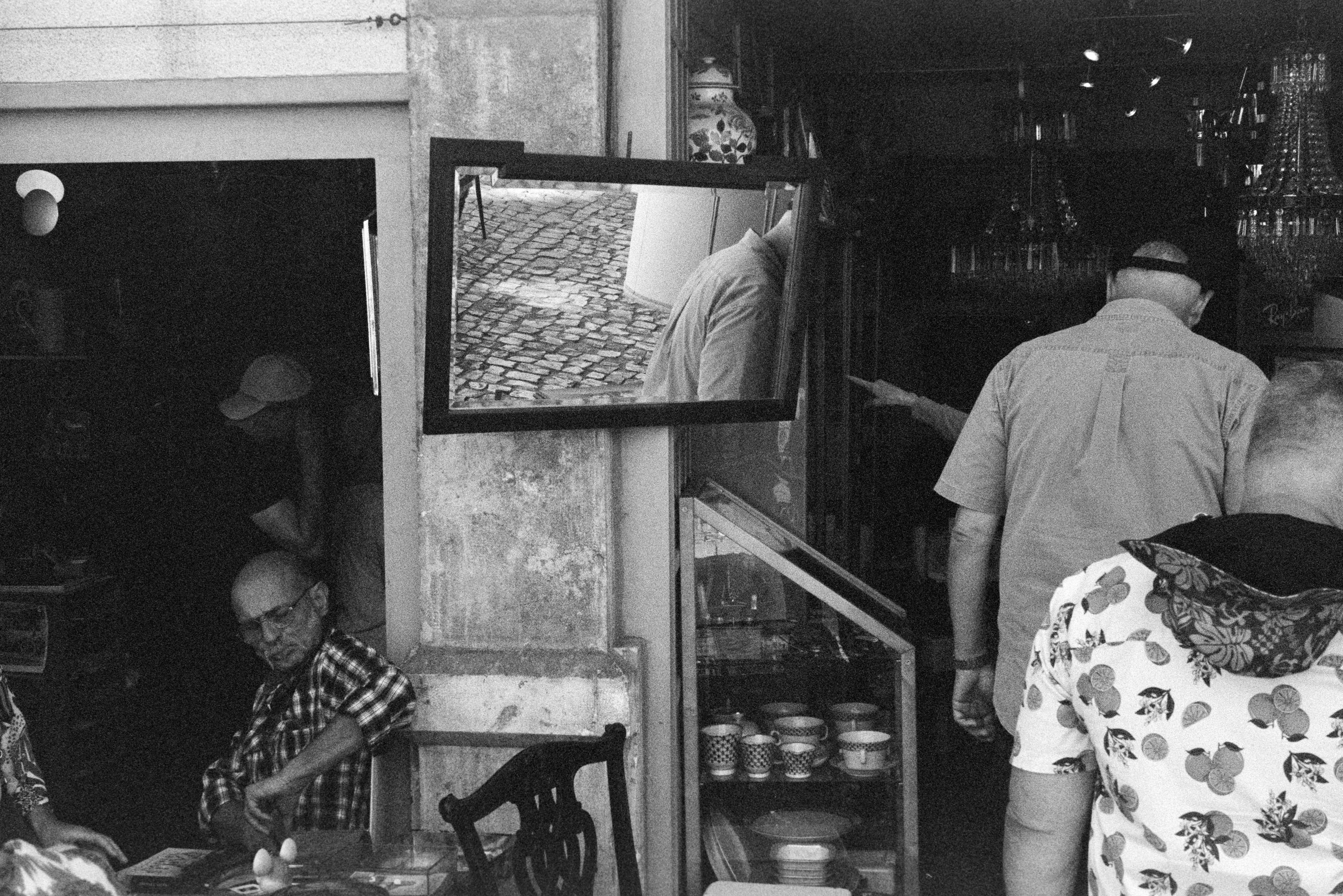

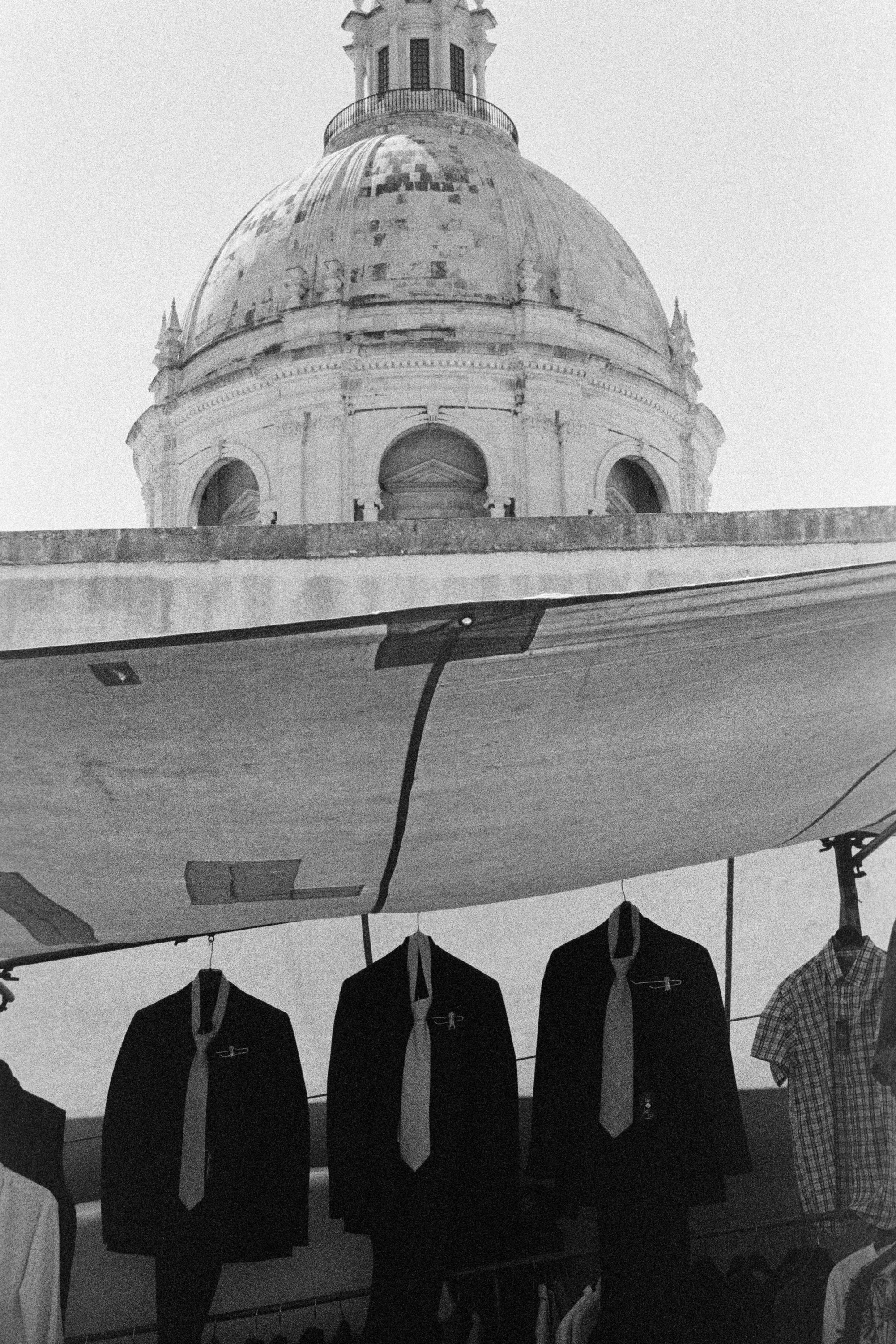

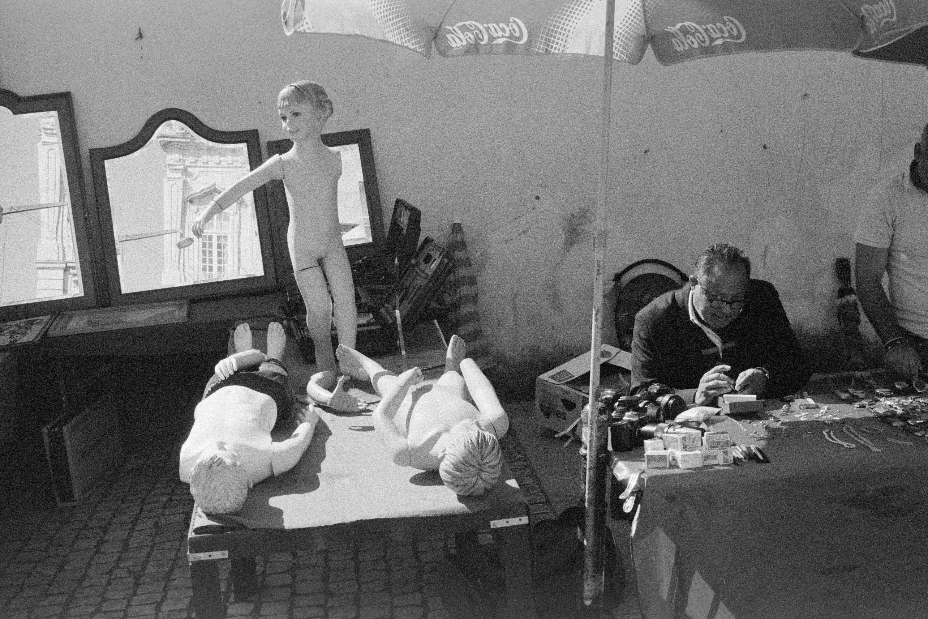

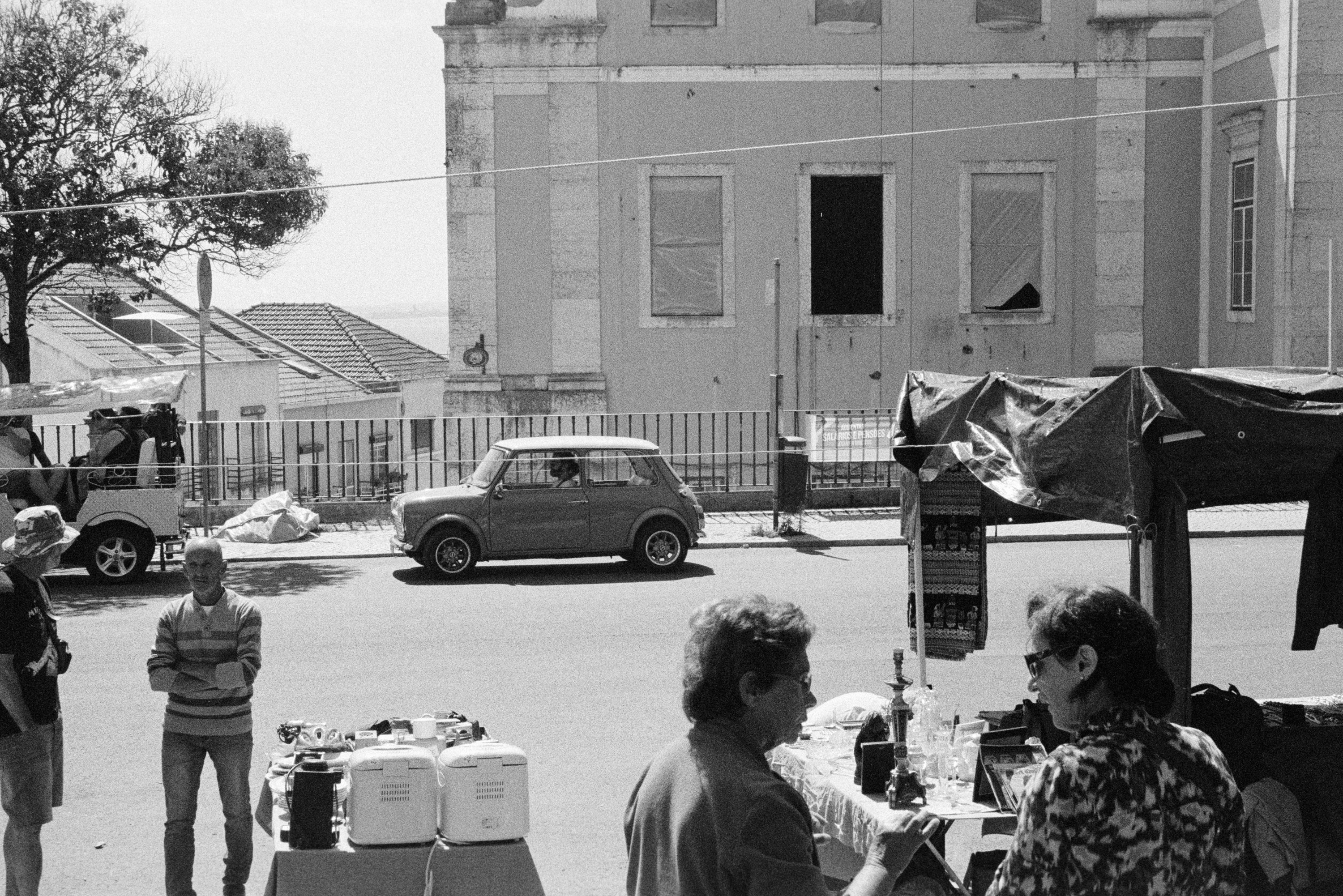

Just scanned my roll. It turned out quite grainy, which I don't mind, but it seems underexposed, which is strange as I was shooting on a bright sunny day at f/16, 1/1000, and ISO 1600. I was hoping it would be overexposed. What do you think, is this underexposure or something with the development? The scanning shouldn't be an issue, as I used the settings that I always use for my scans with a digital camera.

They aren't bad at all. Pushed film does tend to look underexposed. You are exposing the film at 4 times a shorter speed. When you push film the shadows won't increase in brightness as much as the highlights. You could try a milder 800 push next time and see if it's more acceptable to you.
I like shooting at 1600 speed as it provides flexibility in different lighting situations. I just wanted to know if this is how it would look, or if I messed something else up. To me, it looks okay; maybe I'll need some time to get used to it.
You can also try shooting at 1600 and developing as 400. The negatives will look thin but you may find the scan actually gives you a very usable image. The contrast will be lower. I once shot Fuji Neopan 400 at 3200 by accident with no change in development and was amazed that I got some great shots. It's just a little hard to see the frame lines where to cut the film.
Some of it may be down to how you handle the images in post.
Ha, I once shot Neopan Acros 100 at 800, and for some reason gav it to the lab to develop it together with a bunch of other rolls. I asked them to push Acros by 3 stops, but they said it wouldn’t be good, and the furthest I should go is 1 stop, so I let them do whatever they thought was best. I got such thin and flat negatives back that I simply couldn’t save them in post.
So, hiroh, are these the scans from developing in DDX at the time given by Ilford for 1600 or DDX as stand development? If it's the latter what was the dilution, at what time and what was the source of information
The shadow detail doesn't look at all bad for 1600

Yes, it’s DD-X, but I followed MDC, developing for 13 minutes at 20°C with a 1+4 dilution. I agitated for the first minute and then every minute for 10 seconds.
Thanks for the reply It looks as if DDX may be the developer to use with HP5+ at 1600
pentaxuser
I'd also mention that these images were not manipulated. I converted them with Negative Lab Pro, and it was automatically set to the Lab - Standard profile by default. I didn't even adjust anything further, so this is how they're supposed to look if developed with the method I mentioned above.
