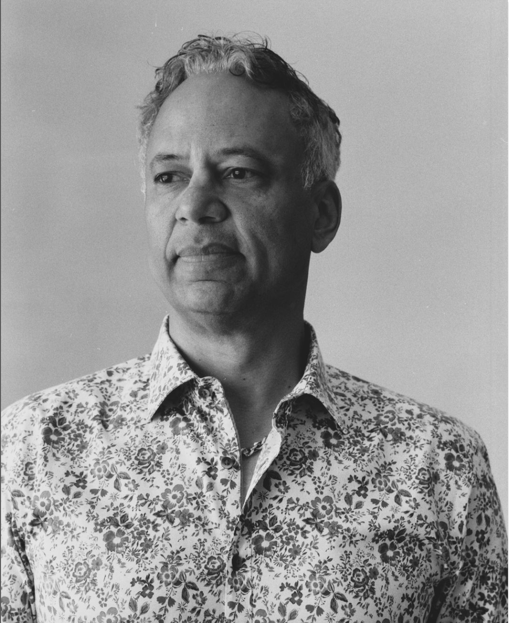

Natural light portrait with HP5+ @ 1600 in DD-X for 13 minutes, as per Ilford's recommended time. 120 format (RB67).
