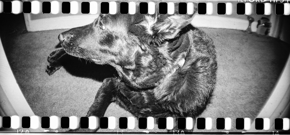

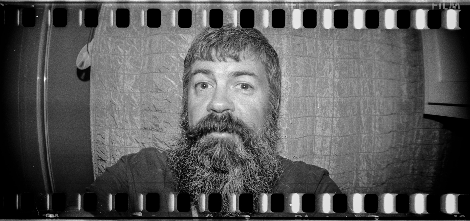

I went and dug up some of the shots from my exposed roll from way back to post so the OP could see that all is not as dire as it seems.
Both of these shots were from the second roll, As you can see the normal 35mm frame area is fully and completely fine. The only issue is the sprocket area. The first roll was a loss however, but it was the roll that took one for the team so to speak.

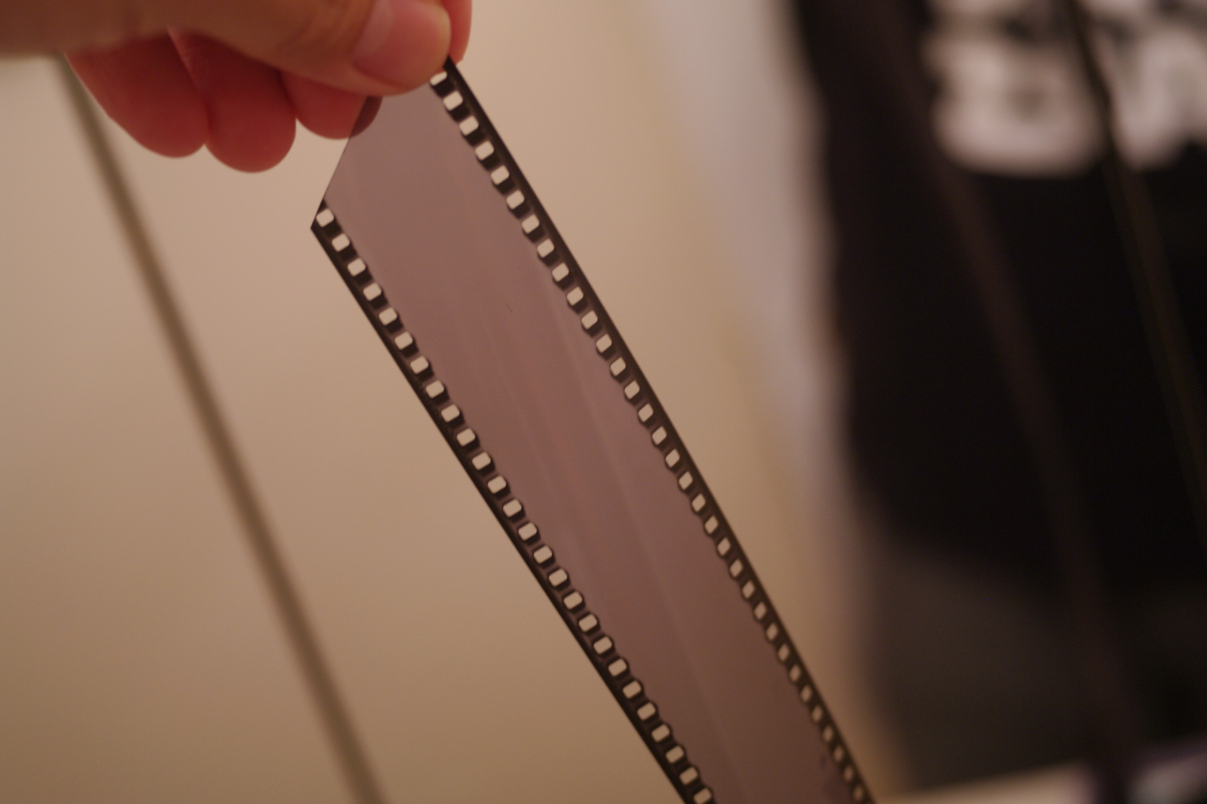

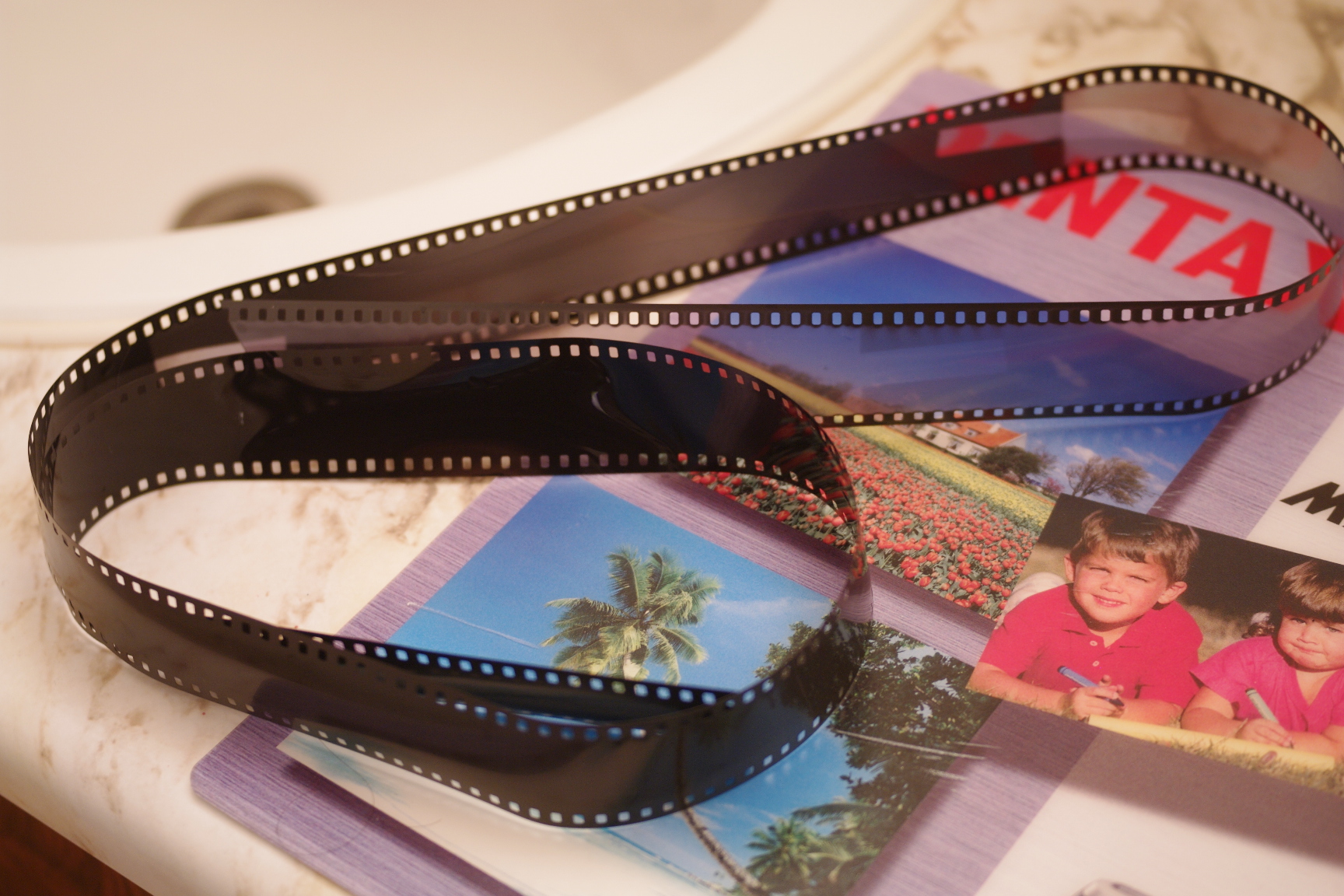

UPDATE:
So I managed to process a bit of the roll and it seems that, after a few feet, it clears up and looks ... OK and usable.
I was actually pretty impatient and tried out a bulk roller, hoping that somehow the roll I used had the "still OK" parts of the film. Thankfully, I cut just past the OK section so looks like my first bulk roll should be OK.
thanks to Dennis on helping me get started up on bulk rolling film.
