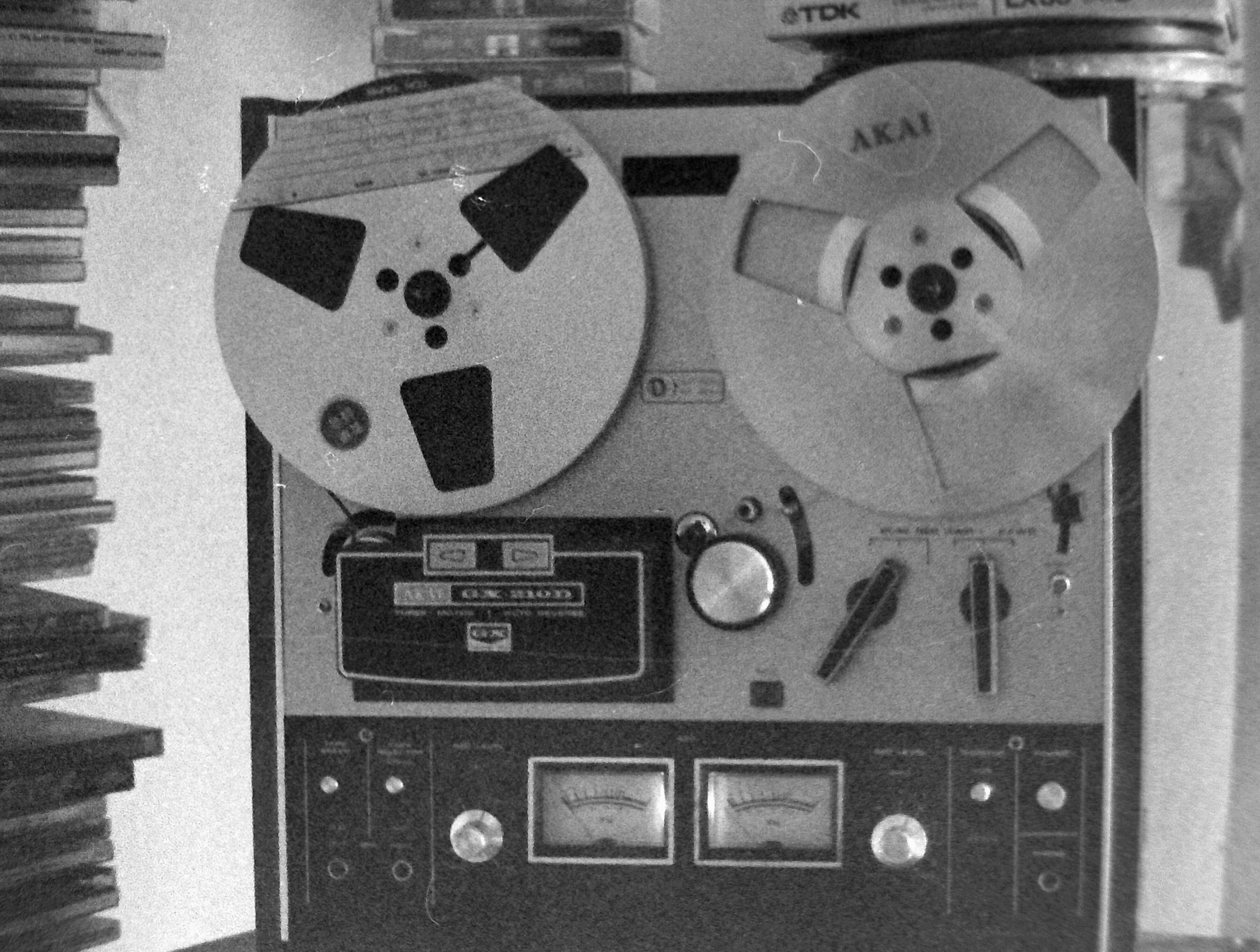

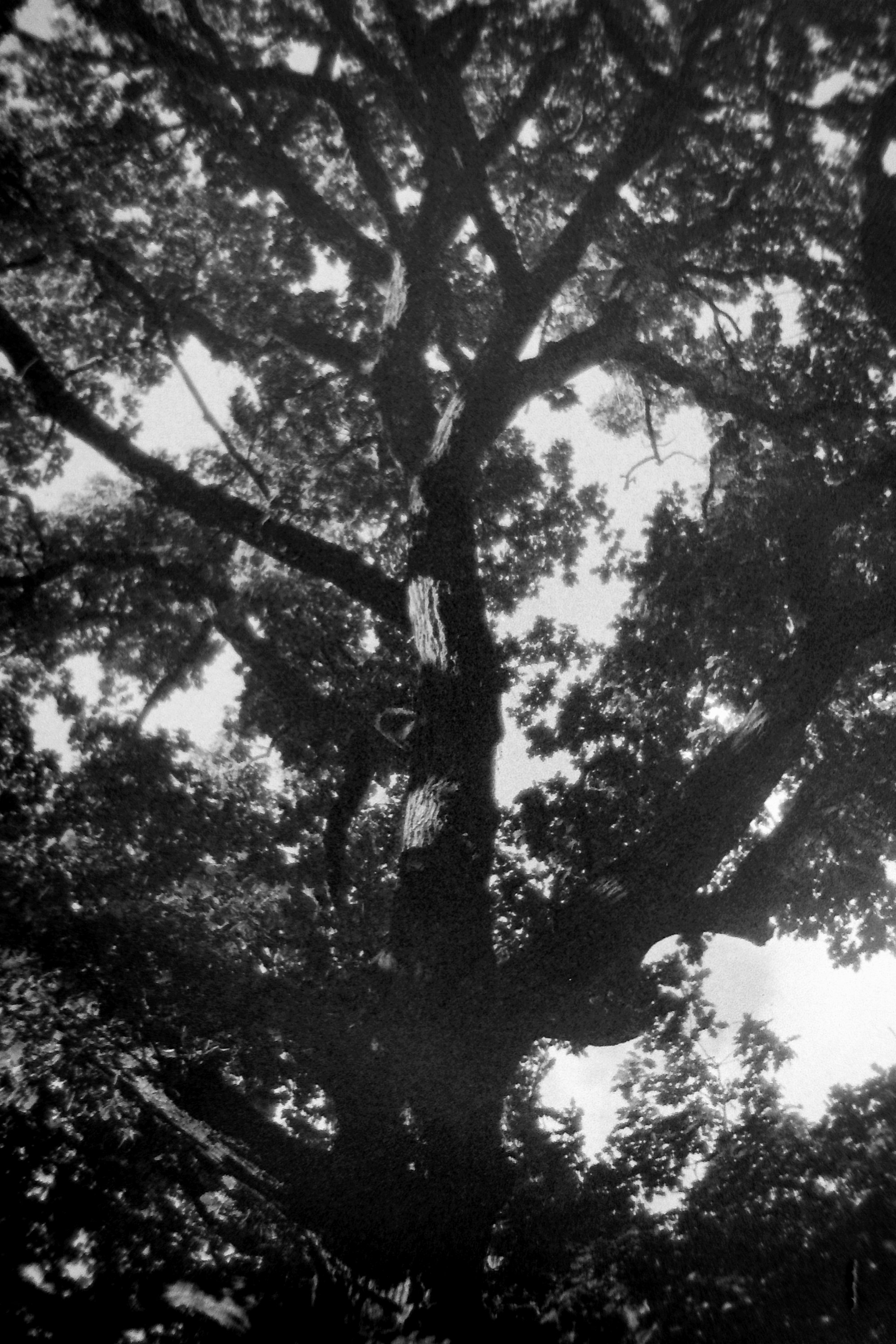

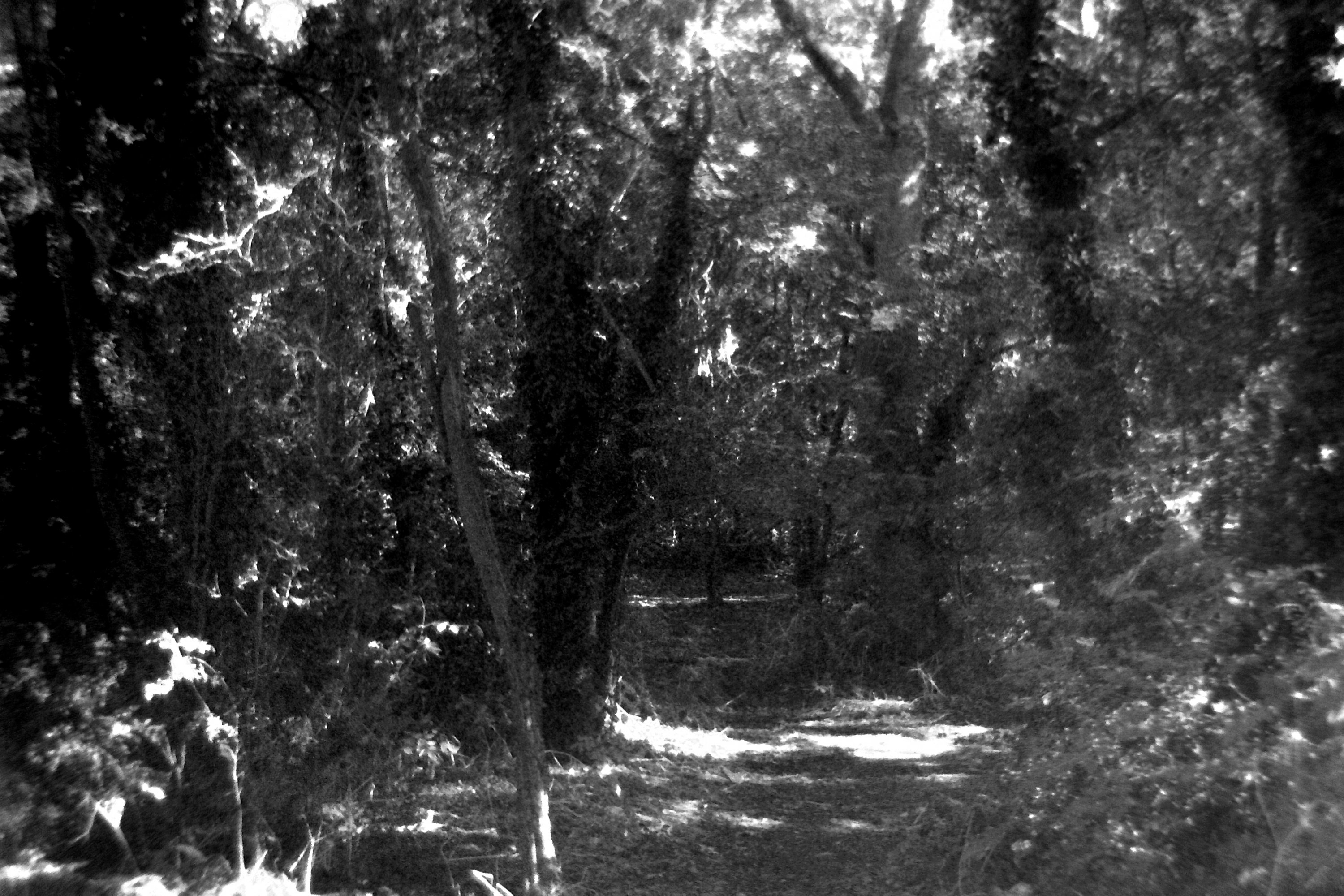

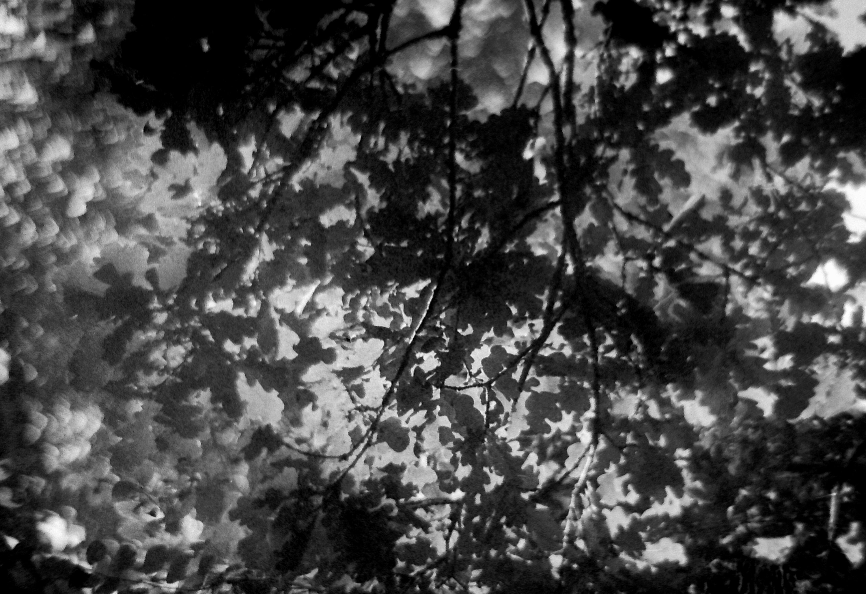

OK I spooled off a couple of feet into a cartridge and shot 6 exposures at 400ISO in my Nikon F601M just to test this. Processed in ID-11 for 7 minutes 30 seconds, two inversions every minute. To be honest I wasn't being as careful with the shooting, processing or fixing as I usually am...I was just getting a feel for if this stuff is usable.
It has the slightly rounded sprocket holes as expected, but no issues in camera. Inside the metal can is a thick black plastic bag, containing the film on a 2" core - entirely as expected.
E14507 and "Ilford Safety Film" is on the edge. There is some base fogging but all 6 exposures yielded fair images. I would definitely not use this for a competition (not that I ever enter anyway) but I would think rated at 200ISO or given an extra minute processing it's absolutely fine to use as an every day film.

Nice Tape machine BTW
Yes that's correct, the numbers and film type read backwards from the usual side for still photography. I'll experiment some more when time allows but the film is usable, and I paid peanuts for it really. I can see why photography students would use it. For me, it's more fun. I get the impression that the shop has plenty left.
