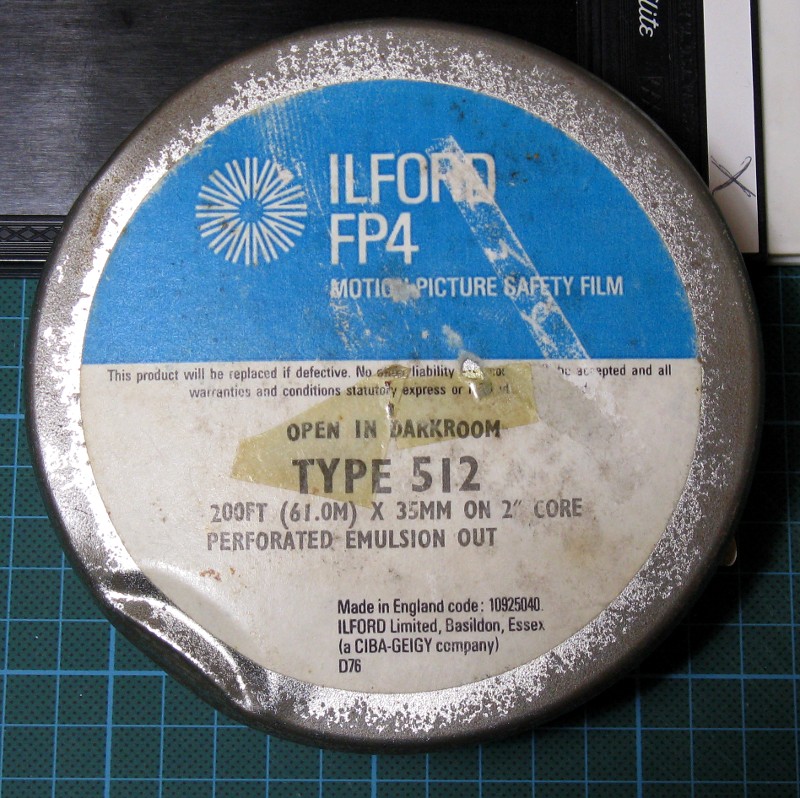

I think the material mentioned by the OP is like this stuff that I used to use as a student, about thirty years ago - and it was old then! I loaded the film into cassettes measured by feel against a piece of wood with two nails banged in to it, at night, up in the roofspace. It worked adequately and didn't destroy any of my few 35mm cameras. Probably not the thing to run with a motor-drive though, as the perforations are a tiny bit different.
I'm assuming that the OP has a can like my prehistoric one, currently used to hold short remnants of other bulk rolls. The markings of the grid on the cutting-board behind are 10mm and the printed label has a diameter of about 107mm.
Development now would depend heavily on what has happened to the film since it was made. Try the FP4 first, expose as though it was 64asa and develop for the standard time - adjust exposure and dev from there. If you have a choice of developers use the least foggy one.

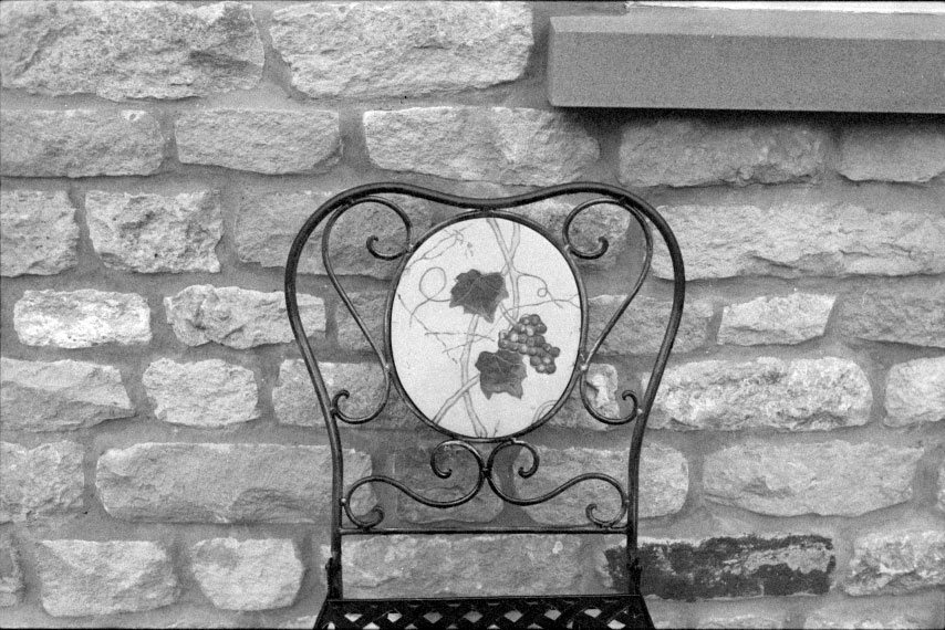

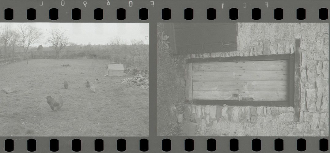

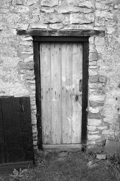

Had chance to process the film today.
I decided to try the HP5 as a test and used about 5ft in my Nikon FM2n - hopefully no damage done....
I exposed at 400 and processed it in ID11 1:1 for 13 minutes. (the only dev I have on hand).
Yet to print anything but the scans aren't too bad.
Anyway, it seems to work!
Thanks for your help and advice.

The F in F069400 is the code to indicate what film you shot BTW, I think the sceme was A or B for Pan f C or D for FP4, etc. Just think FILM Ferrania is talking about the film of Fellini, but Ilford was probably the Film of Hitchcock

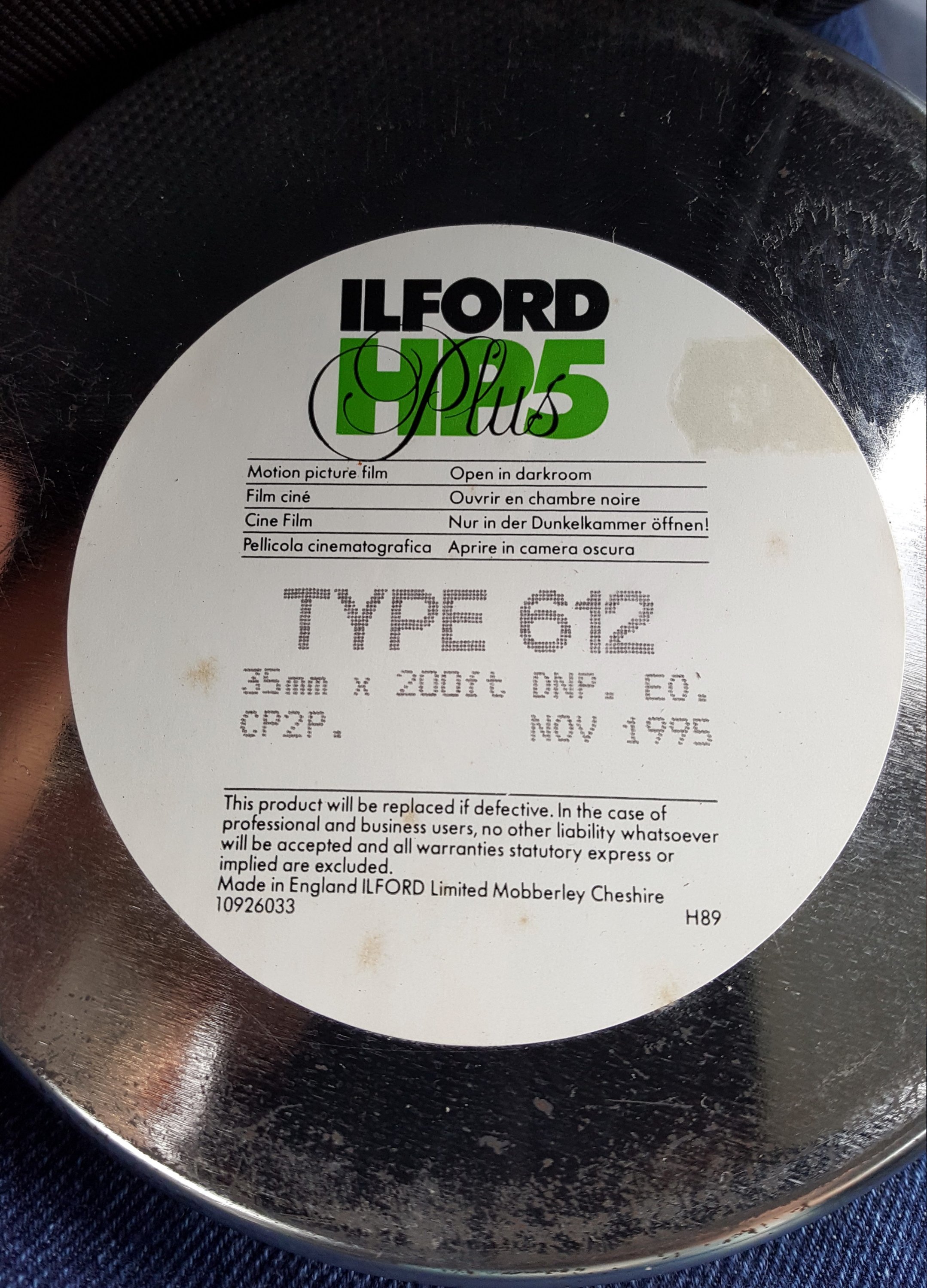

My local camera shop has some 200' cans of HP5+ motion picture film which they say they are successfully selling to students. I picked up one can yesterday, seems to be a similar product to the one described in this thread. The chap in the shop told me it's emulsion out, though there's no indication on the can label. I guess I will find out when I open it!
Any more info on this film? Is it likely to be similar to the one discussed in this thread?
So far as I am aware (having also checked the Harman website for cine-film stock-numbers) the cine-film mentioned in the 'old' part of this thread was discontinued long before the Ilford/Harman split in the company. Those emulsions were not the 'Plus' variety.
If your local shop are faking up labels saying HP5+, containing forty year old cine-film then they won't be in business very long! The same goes if they are re-labelling Orwo or Foma cine-film. Or this stuff could be the leftovers of a special-order someone gave to Harman, which could be very interesting.
When you open up the tin, look at a scrap of film in the daylight (the bit where the tape sticks down is always slightly damaged, so just snip that off in the dark) and check the perforations. If they are the usual rectangular-with-rounded-corners shape then it was not perforated as cine-film, while if the shape has curved long-sides then it was perforated as cine-film. Next is to check the edge markings, if they are footage markers (rather than exposure numbers) then it was originally made as cine-film, rather than being something(?) else. If the edge markings are exposure-numbers and the film name, then you have a different answer.
Please let us know what happened :smile:
EDIT: Dohhhhhh, then I looked at your attachment picture in a magnified view (I am on a small-screened device at the moment) and saw that there was a date of November 1995 on the label! So it is old stock from somewhere, not a new order number. If you are lucky, then some film-company, somewhere just cleared out their film-fridge -- if you are less lucky, there were a few packing-boxes rediscovered after being stuck high up in a hot warehouse all this time!
