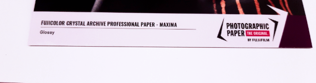

Take a factory fresh roll of DPII or Maxima, fix it out (avoiding any risk of brown stain from blix), wash, dry and evaluate. It seems white only until you compare it with an actually white paper (darkroom or inkjet). Then the difference is quite painfully clear.
Anyway, we digress. I'd rather not be responsible for a vicious bout of cognitive dissonance.
Edit: Maxima print from official Fuji sample kit (dark-stored) on top of generic RC inkjet paper.

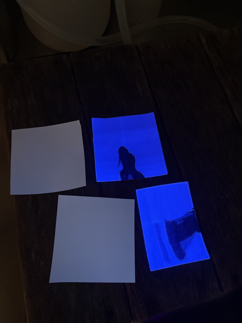

Optical brightening? Oh yeah Galerie has it. Side by side with Kodabromide F which as no brightener.
