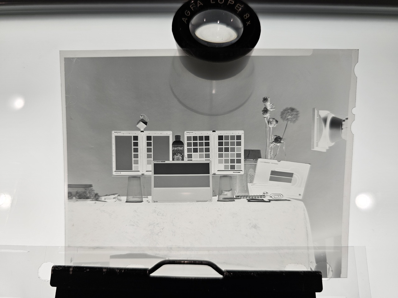

Looks like my problem was either bad film or wacked shutter. The only thing I changed was mixing a fresh batch of developer. Time was the same 5:10 @ 75 degrees. This is a cell phone photo so the contrast is higher do to jpg processing. The 120 film did show some mottling due to known bad stock from the pandemic however I haven't seen it effect exposure this way. I did use a meter on a few frames so even if the camera meter was way off which I dont think it is, I guess the only thing left is a bad shutter. I have no real way to test other than listening to a one second exposure and it sounded right. The camera is not worth getting CLA’d so I’m a bit disappointed. I will reshoot these shots using a spot meter and a serviced Rolleiflex as I want to learn how to get the best images out of scnes with very high SBR.
