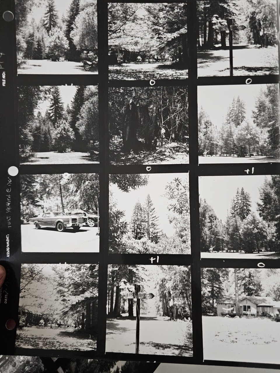

I have been shooting this film for awhile and last roll was a disaster for darkroom printing but my mirrorless camera scans are fine. In order to get a decent contact print I had to go to a 00 filter. I’m pretty sure my mistake was to use the highest developing time listed on the massive developing chart. I have no idea why but the times listed for FP4 using Kodal HC110 are 7,8 or 9 minutes. Why three choices? I used 9 minutes and my images were shot at either normal exposure or +1. I was testing a new Yashica 124G and felt the meter was of by -1. I mostly used it’s meter at 0 and +1 exposure times and occasionally checked with an exposure app. Here are the OO and #2 contact sheets and the negatives.

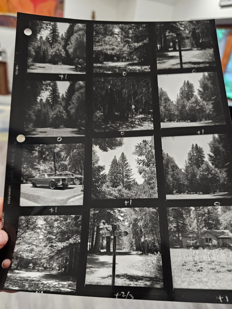

Underexposed, and way too overdeveloped for such contrasty lighting.
+1
Best best is some basic testing. Look up John Finch of Pictorial Planet on YouTube. He just did a multi-part series on what he called "The Easy Zone System."
The meter on those cameras is really rudimentary. Under the conditions you were photographing, I'm not surprised your exposures are all over the place and tending towards severe underexposure.
The first thing, as others have mentioned, is fix that issue. Consider carrying a separate light meter. Doesn't have to be a spot meter, although those are certainly nice, too. Practice with it and notice how large the contrast range is in the kind of forest scenes you shot on that roll. You may want to keep this into account also when composing.
Development comes next and I'd suggest sticking in first instance to the development times listed by Ilford for their own film:
Left column is the time for exposure at EI50, middle = EI125, right = EI200.
In your forest scenes, it would have made sense to set the EI to 50 on your meter, measure the shadows for e.g. one stop underexposure and give 6 minutes development in the B dilution. Don't hesitate to err on the side of overexposure, in general.

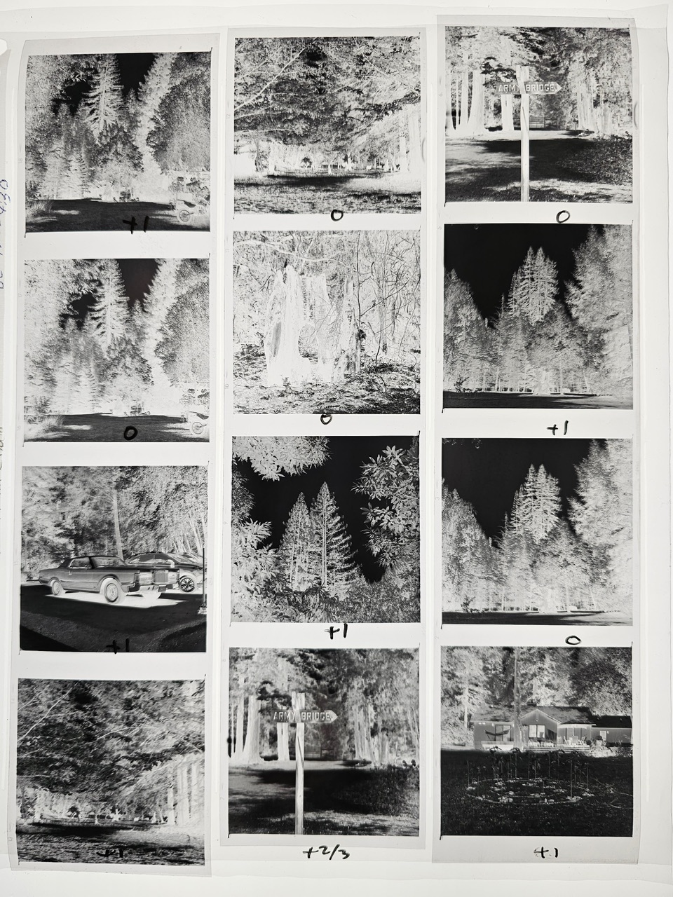

Now those are negatives with muscle :smile:.
It is a bit difficult to tell whether they are actually under-exposed, although the may be. I often photograph in the forest, and my good negatives often have significant portions in them with very little density in the shadow .
But those highlights are very over-developed.
As koraks posted, use the manufacturer's references before the MDC. Ilford first, and then Kodak's as a backup.

Averaging meters in harsh contrasty lighting almost always underexpose. That's because they choose a midpoint in the subject brightness range to render as middle grey. That's fine if your SBR is "normal" or less (7 stops or less), which gives you three stops below and three above the midpoint, which means the shadows get adequate exposure (3 stops less than middle grey is about the limit for a shadow that has a tiny bit of detail).
But if your SBR is 10, as it could easily have been in the OP's case, then the midpoint ends up leaving 4 or 5 stop below and above the midpoint for the film to record. The high values will record satisfactorily on most modern films, but four stops below middle grey doesn't get recorded on the film at all; just clear negative.
My advice for using averaging meters has always been to overexpose one or two stops in contrasty situations. If the OP's meter is underexposing already, then those negs might even be 3 stops under.
Couple that with the overdevelopment and you're going to need a 00 filter or more and end up with blank shadows.
So, OP, use this as a test. You now know to reduce your development time and to rate your film slower (or give more exposure compensation) in contrasty situations. Keep adjusting as needed till you get the results you like.
It's not rocket science; just follow Kodak's time-tested advice: If your shadows have too little detail, expose more (and vice-versa, but overexposure is much less of a problem). And if your negatives are too contrasty, reduce development time, and vice-versa.

No, they are exactly the same (with Ilford's EI 125 dilution B figure matching the high end of the range on the MDC).
My developing notes went with the 9 minute time for FP4+that equals 5.11 minutes in my processor.
Uhm, no. If you want to correct for continuous agitation, you'd end up at something like 7.5 minutes or so. Unless you're developing at a significantly higher temperature, too. At that point it becomes a lot of guesswork of course.

I don't see where you've stipulated your degree of HC-110 dilution. 9 minutes would be fine for HC-110 diluted 1:31 from concentrate or 1:7 from stock solution (dilution B). But it would be nuts with dilution A. And you'd have to shorten that quite a bit for 75F, versus normal 68F.
Otherwise, relying on TTL averaging meters for contrasty black and white scenes is always a gamble, and rarely a successful one.

Looking at the information I normally rely on, it seems to me that a 5.11 minute development time in 75F HC-110 dilution B should lead to much less density than I see on those negatives.
I would seriously check your temperature control.
Assuming of course there is no problem with dilution.

Exactly, that's why I am scratching my head. I'm looking at 4x5 studio test shots I took a few years ago with those parameters and they looked awesome. I maybe having a senior moment. I'll sort this out and reply back with my findings.

Expose more, at least one stop, and develop 30% less and report back.
