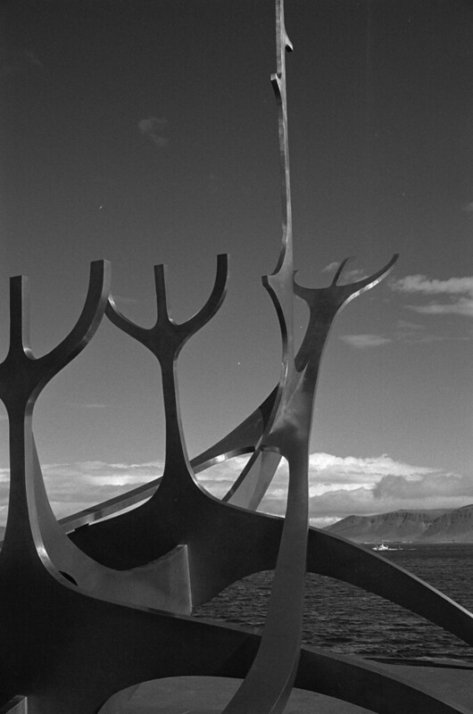

I favour a semi-stand as mentioned above with agitation for first min then at at say 4,8,12 mins for 18mins total but it is very tolerant.
I hesitate to recommend a speed for FP4+ you need to test to your taste.
This @18 mins as described on 35mm stock yellow filter 35mm f1.8 w Nikkor S mount.
Sun Voyager Sólfar Reykjavík Iceland
