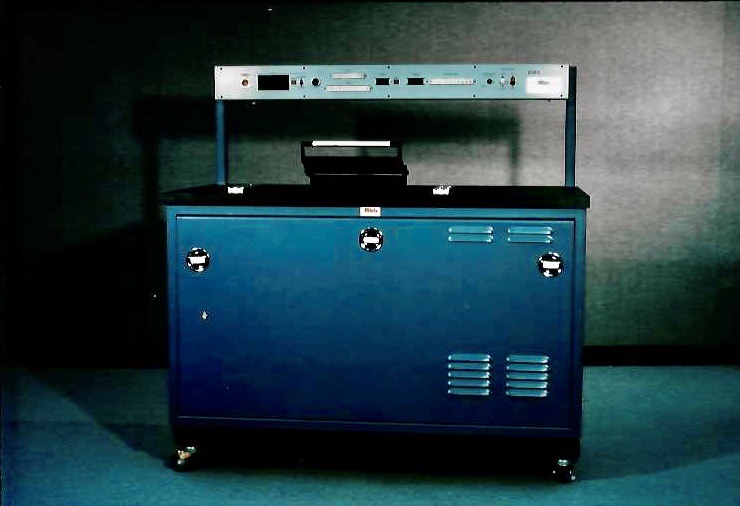

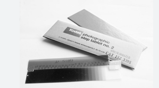

For those here using densitometers and compiling contrast curves, what is the method for applying a known exposure to the film calibrated to the desired units? Is it done by photographing a chart under known/measured lighting conditions, or some other way?
By using a step tablet and preferably a sensitometer.
By using a sensitometer
