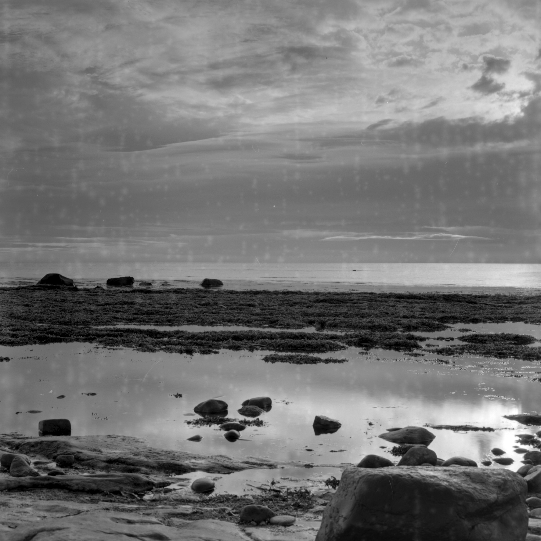

I almost exclusively use FP4+ in my SQ and until now have escaped the dreaded speckling. Attached is a rough scan of one frame.
Roll 8 of a 10-pack showed it on most frames. I reported it to Ilford who confirmed that it was one of the affected batches, produced between their two announcements. I’d only seen the first notice so assumed I was unaffected.
The response was prompt and they’ve sent me replacement rolls plus some extras.
I was initially puzzled as to why it had only happened to one roll until I thought about the specific circumstances. Firstly, I used the roll over several months whereas I would usually complete a roll in one outing. Secondly I left my camera in the boot of my car overnight in October in Northumberland - cool nights, mild day, some sea fog.
I’m posting this for information purposes - I have no complaints about Ilford’s response.
I’ll be using the remaining two rolls from the affected batch with my usual cautious approach and am confident all will be well.
Sig.
