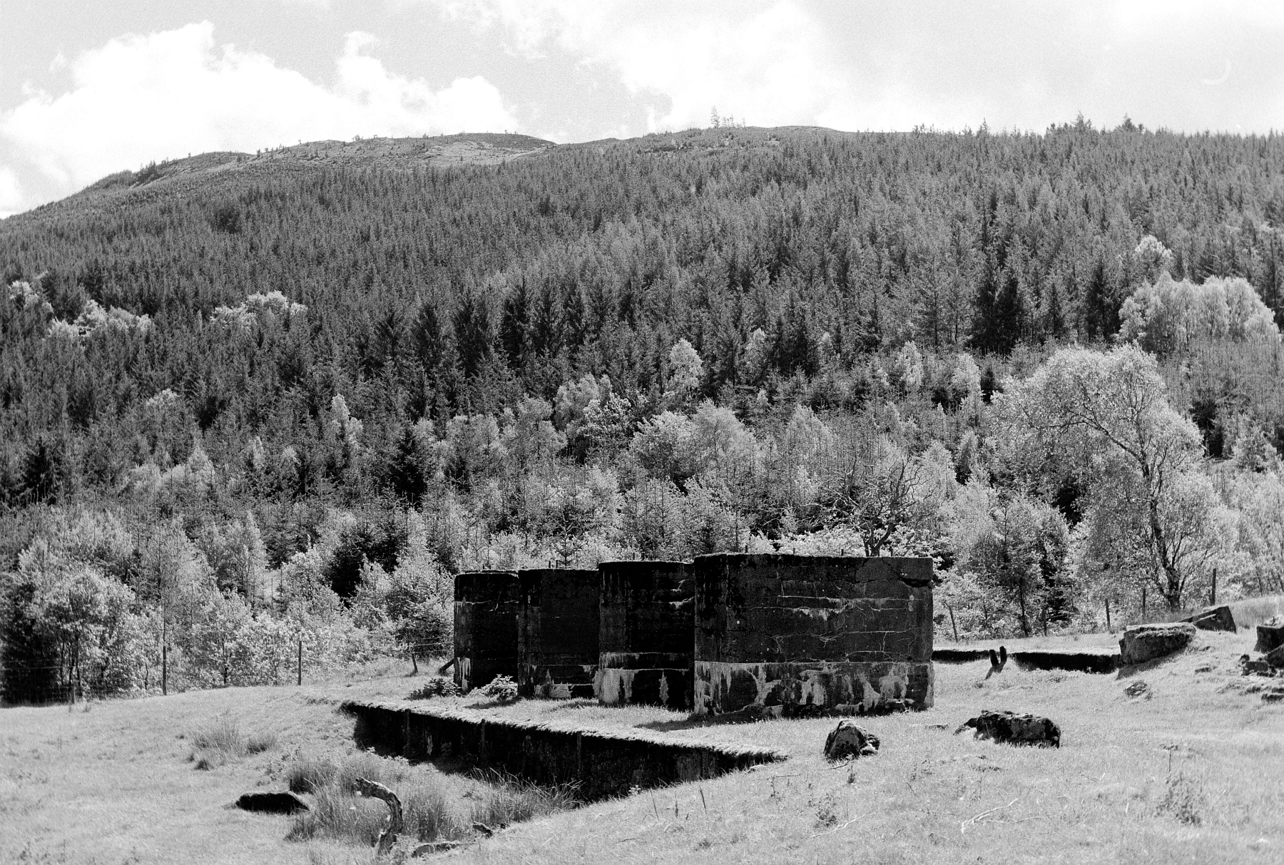

I've shot mostly on Ilford film and it's never been contrasty - except on one occasion when I developed a roll of FP4 plus in HC110 at dilution B. It was my first go at HC-110 and all I can think of is that the temp was inadvertently higher than 20C over the short developing time. It's not displeasing, either: not to me, anyway. It was at the height of summer and I found that the foliage took on an 'infra-red' look. I need to try the same film / developer again but keeping a better check on temp to see if it happens again.
