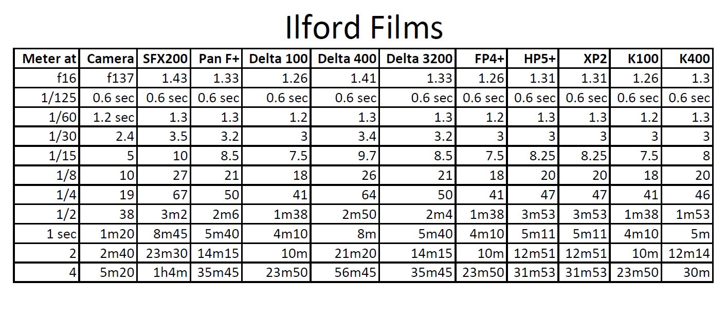

Took a while to put this together but I don't like to bring a calculator with me. Instead I make a chart I can refer to using my camera's f stop and which Ilford film.
In case anyone else would benefit from this I am passing on an image of that table.
This works for the RSS 6x9 (Reality So Subtle) which has f137. The factors of the films are listed under each film, then the calculations using that factor are below that. Meter at f16, find your film column, get your exposure time.
So you're factoring in an f/stop conversion and a reciprocity correction. I'd find the two more useful separated, since I have a number of pinhole cameras with different hole sizes and projection distances. On the other hand, I use the Ilford exponent system (virtually identical to Gainer factors), so I don't need a chart as long as I have my phone (with scientific calculator app).

I'm thinking seriously about writing an app, a Web App that will allow someone to enter in f number and choice of films, I plan to research all of them over again. (I had all this before, but penciled it on paper, and only had one copy and the man who bought my last pinhole camera years ago begged me for it so I gave it to him.) So the web app would export to you a file that has this chart in it and you can then print it out or just view it on your phone. I'm a huge fan of printing out and having it to look at without using any other electrical devices. This way you can still photograph with a simple light meter, no batteries. And as for me this works best due to my desire to bring this camera on trail with me for long journeys and take one shot a day minimum, to document my journey. Out there I may not have batteries after 7 days without a resupply/town day. I might even select the only films I want to shoot (Bergger Pan400 is top on list and maybe it might be the only one actually after I re-try HP5 and compare against it) print it out and laminate it and tape it to the back of this camera.

That's a very sensible way to handle primitive location photography. As noted, I'd probably just print at table of "1 => 1, 2 => 2.5" etc. for a single film, and take only a single film for that kind of expedition. ISO 400 negative film is easily the best choice (but Fomapan isn't the best one, don't know where Bergger gets their stock).

As for Bergger, they have no reciprocity index listed, but instead suggest for shots longer than 1 second to increase one stop and if longer than 1 minute to increase two stops. That's their formula. I tried it in the past, it works exactly as stated, and when you compare anywhere on the exposure chart and do a comparison of 1 stop versus the reciprocity X^Y math, and Bergger is way better than any Ilford film. By a long shot actually.
For instance an exposure time of 38 seconds at f137 calculates to 1:20 adding a single stop. HP5 reciprocity turns 38 seconds into 3:53. I'll take 1:20 over 3:53 any day.
