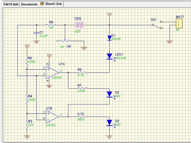

The battery switch is really a simple electromechanical switch. If the LED comes on even with the switch turned OFF, this means that there's a leakage current through or parallel to the switch. My guess is that this is due to fouling of the switch itself or the PCB. I'd open up the unit and see if cleaning it inside helps any. If not, see if a replacement switch can be found; shouldn't be too difficult to work something out.
Thanks much. That shows the switch the way I would have expected it to be which made it pretty difficult to believe what I saw.

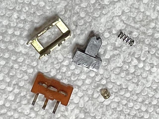

The inside of the EM10 was remarkably clean but the switch had some goopy stuff here and there (those cheap slide switches usually have a bit of lube). So I unsoldered it, and being me, I bent back the four tabs on the switch housing that retain the block with the contacts. I then took all the switch parts and swished them around in denatured alcohol. Somewhere in this process, I found two tiny beads of solder -- less than a millimeter in diameter mixed in the goop. Now that could have just happened but if it was original, it might certainly account for the earlier behavior.
I lubed the pressure spring, roller, and contacts with a teeny dab of silicone grease and gingerly put it back together. After putting it back on the PC board, all appears well; switch closed 2.4+ Ma, open ZERO -- YES!

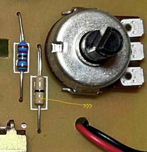

So it's back together and appears to be working. I shall note there appears to be some component value differences and one "mystery component" compared with the schematic from @koraks. The PC board does have "ISS. 2" so mayhaps there have been some revisions along the way. I couldn't read the printing under this component without unsoldering one end and decided I didn't need to know that badly. Maybe some sort of reference junction -- or CIA encryption code ... 😎
So thanks again for the input.
The marked resistor is a zero ohm resistor. It's the electrical equivalent of a piece of wire.
