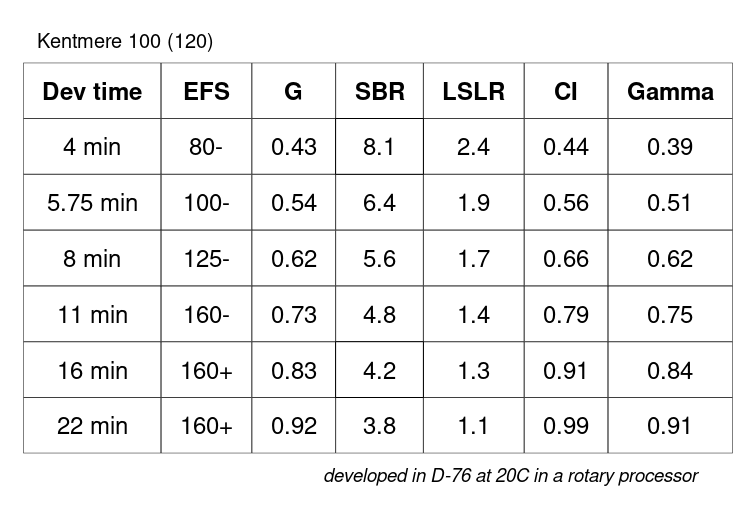

George, you'll have to get a roll of Kentmere 100 and see is your can push develop it to 400. It will only work if it's a good push film. It's something that I plan to look into, especially the 400 speed.
aparat
Sep 5, 2007
1,177
Saint Paul,
Good point. I recently ran a test of Kentmere 100 in 120 size, developed in D76, and I found the effective film speed "pushable" to only about EI 180, but contrast is very high, with CI reaching 0.99 (with a 22 minute development), which would be difficult to print. Here's more detail:
