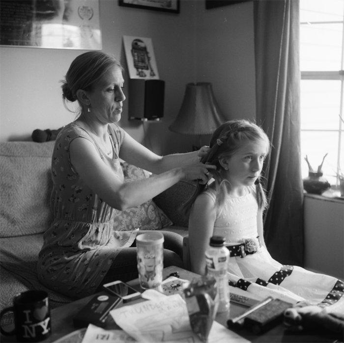

OK, so I loaded two rolls of 35 and one of 120 into the tank thinking they were all films that I soup for 10 minutes -- Tri-X and HP5 -- the HP5 is supposed to be at 12 minutes, but I find at 10 it gives identical results to tri-x, and since tri-x is supposed to be 9.5, what the heck, an extra 30 seconds won't kill it.
However, the roll of 120 as actually some Delta 400 I have been shooting, which is supposed to be done at 14 minutes -- a significant increase. Was I risking massive underdevelopment?
Apparently not. I decided to lose 12 shots rather than 48 on the two rolls of 35 -- which would have been really overdeveloped if done for 14 minutes -- so I did the whole thing at 10. When I took the 120 out, well, the negatives looked just fine, with even tones and a nice spread of shades of gray and all that. Really excellent shadow detail.
Anyone else have this experience? I kind of like these results.
I should note: D76 1:1, 68 degrees. I metered with an incident meter, aiming for proper exposure in shadow areas especially when backlit, so I'm guessing I just mellowed down the bright areas, an inadvertent application of the zone system, or something.
thoughts?
