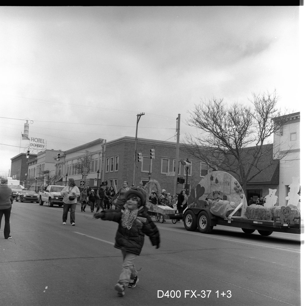

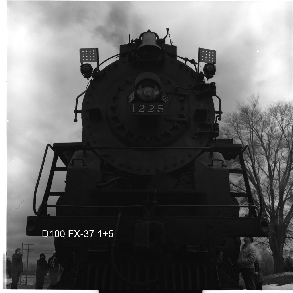

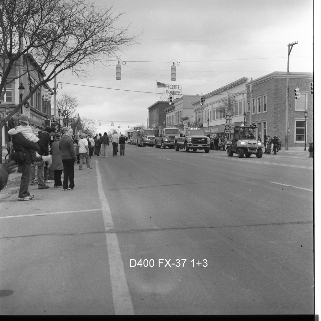

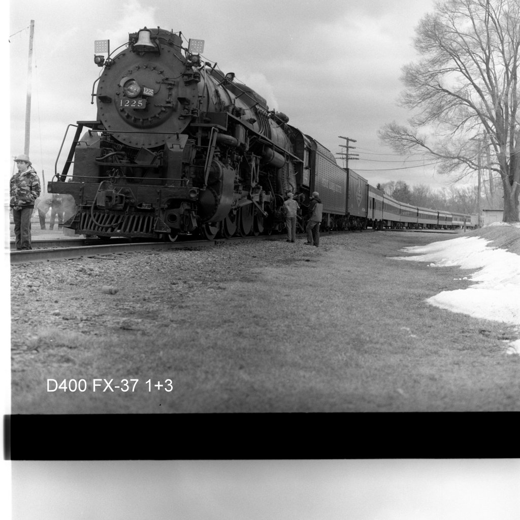

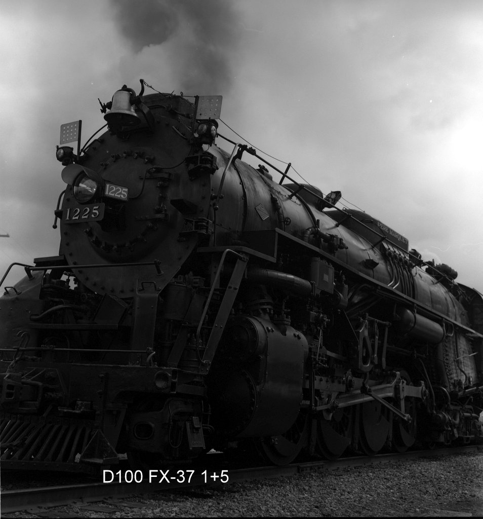

Well, they are not perfect, but they are pretty much "straight" scans with no tweaking. Some are from Delta 400 in FX-37 at 1+3 and the rest are from Delta 100 rated at ISO250 in FX-37 1+5. The shots were from Clare, MI. St. Patty's Day parade and train ride. I'll wet print a couple either tonight or in the morning. The D100 negatives shot at ISO250 seem to have pretty darn good detail in the shadows of the train and when I played with curve in scanning, but these have had no curves or shadow/highlight work. 1-Image3 D100 rollei fx37 1+5.jpg2-Image9 D100 rollei fx37 1+5.jpg3-Image6 D100 rollei fx37 1+5.jpg4-Image3 rollei fx37 d400.jpg5-IMG038 Rollei delta400 fx37         .jpg6-Image3 Rollei delta400 fx37.jpg

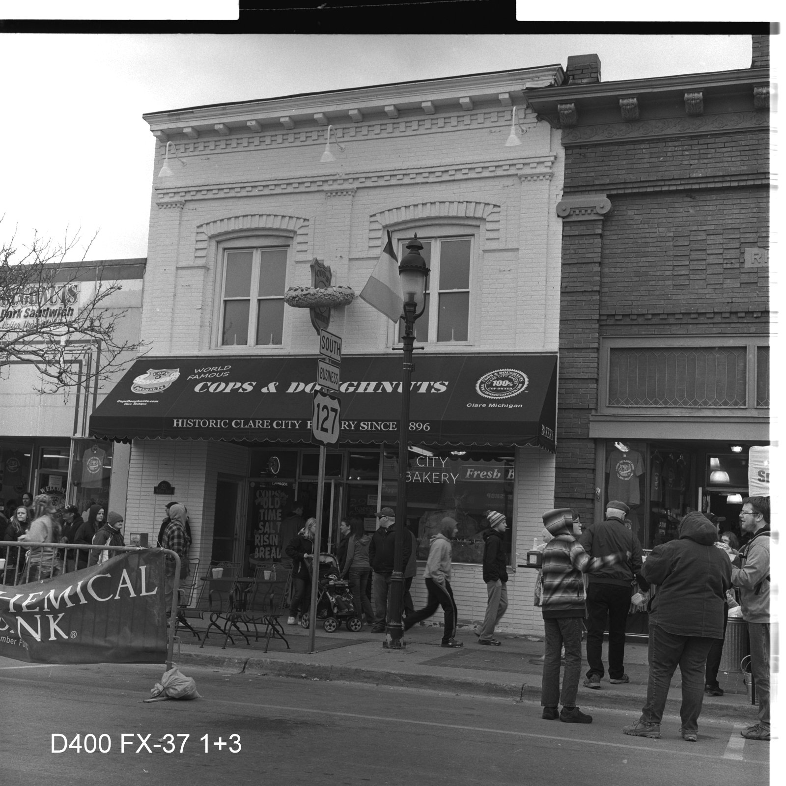

Here's two more and the last one is a "must stop at if in Clare" type of spot. Cop's and Doughnuts is famous and ships around the world. Well, at least I know they ship to our servicemen and women overseas. 1-Image2 d440 rollei fx37.jpg2-Image1  rollei delta400 fx37.jpg

On my screen the shadow detail is poorly differentiated though discernable. Maybe that's a scanning or web issue, but muddied shadows with poor gradation is exactly what I'd expect with underexposed Delta. You'll get "something", but will also inevitably sacrifice something in exchange.

I think the fact that it was an overcast day saved your butt, if shadow detail is what you're after. Personally, I always thought shadow detail was overrated, but it's easier to tone down shadows while printing with a full range negative, and make it look good, rather than intentionally shooting negatives with thin shadows. You never know when you might change your aesthetic.
Drew,
These are straight scans from my Nikon 8000 and have no sprucing up. I could have popped these up in the scan software or post-scan, but wanted to see how they came out without being doctored. Printing with my Ilford Multi-grade head at 2 or 2 1/2 will be the real test and I'll do that tomorrow. Yes, the shadows are a little under, but I do see pretty good detail in the negative. None of these were important shots and it was really a test run on a Rolleiflex 3.5C I rebuilt. John W
Thomas,
Yes, if it were the day before I would have ended up in much worse shape. It was a pretty dreary day that's for sure, but we had a good time anyway. John W

It seems to me that in those shots that lack some detail, the reason may be connected to the shots being "contre jour" and the large area of bright light from the sky is resulting in an under-exposure which would still have been the case even at box speed.
What I draw from these shots is that on overcast days and without the problem of "contre jour" D100 at 250 is OK and depending on the need for speed might even be a sensible strategy

I took an incident reading at ISO 250 for the train shots and a couple shots are bracketed also. That explains why a few look better than others, but other than that it was still under-exposed. I'll post how they wet print tomorrow. John W

The good news with a characteristic curve like Delta has is that if you're a bit underexposed, you'll still get something recorded down there, because the toe is quite gradual and doesn't drop off a cliff. The bad news is that you will land the shadows where the curve rises very slowly,
so the gradation between the shadow values is not particularly obvious. Depending on the specific subject and conditions, this is one of
those scenarios where the glass can either be classified as half-empty or half-full. It's just good to know, so you can plan and develop your
shots accordingly if shadow detail is important to you.

JW PHOTO, they look just fine, thanks for the scans, this test is valuable to us who might want to push Delta 100 in the future.
From your tests, i would have no fears to use it at 400 if needed (for example, when I only have D100 in the bag.)
