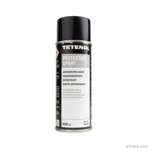

Yes and try and use bottles that hold only enough DDX for one film or two if you develop two together. I accept that in a 1L bottle of DDX that is a lot of bottles to get together so it may take you some time to get enough 50/60ml bottles but once you have them then that's it for life. Until you get that many, you might want to consider spraying a protective gas into the 1L bottle after each decant of DDX.

Learn to preserve well developer. Mixing it with distilled water i alway good for long storage, also displace air, or add some tetenal Protectan spray or bare butane and seal weel. I've been keeping mixed Xtol beyond 9 months, but I always make a drop test to be sure that development will happen.

Sorry for the double post - but what’s protective gas?
Bare butane does the same.
It displaces air/oxygen, if some oxygen remains, no problem, butane is heavier a forms a layer on liquid.
Air duster (canned air) for electronics also works
Thanks for detailed explanations. I read about this drop test elsewhere too, but some say not to risk it and not to go past the recommended time. However I do like the idea of comparing the times against the first fresh batch. Another technique I just read Googlin' around was to drop some marbles (or something similar - I don't have marbles lol) on the bottom of the bottle to displace the air. Interesting idea.
Unfortunately I can't order that spray to Romania - it's just not cost effective given the transport. I'd have to include it as part of some bigger order... Maybe next month... Even using that I wouldn't know how long to push it without the actual test. I do like the test though and it sounds legit. But I wonder - if the time is off after a while - what does that mean? How would I adjust development time? Let's say fresh newly opened developer takes 5 minutes to go black, and then 5 months later it takes 6 minutes - do I just add 1 minute to development time?
No problem... use butane to recharge lighters... or air duster...
