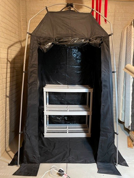

I just set up my tent, and I have two questions (if you don't mind):
-Where do you bring in your electrical cables?
-What duct fan did you use? Any recommendations?
Thanks!

Is there a facility to install a fan?
If the tent gets blown up by the fan one might wonder if there is any air exchange. And any blown out air then likely would remain in the room and finally would be blown into the tent again.
