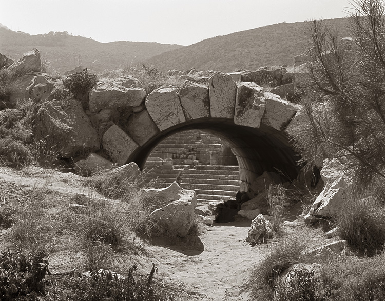

This was taken close to midday in Southern Turkey, it's Delta 100 in Pyrocat HD, there's tones on the bright marble and details in the shadow area of the entrance to the theatre, there's tone in the sky as well, no filter used. HP5 wouldn't be much different.
This us the Racle Temple at Didim

HP5 in Pyrocat HD again middle of the day very bright sunlight and plenty of detail in the shadows (scans can be deceptive plenty in the print). I'm certain FP4 would be just as good it's a case of a little testing to find the optimal EI and development time for a film/developer combination.
Ian
