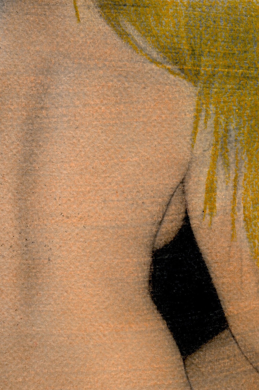

An alternative is to coat the paper of your choice with liquid emulsion. I use Fabriano with Liquid Light. Great surface for hand-painting:
Nice hand painting example! Yes, from time to time I do liquid emulsion as well (I use tetenal). My plan is to get small box of Ilford ART 300, and then if I will like it (and I know I will :smile: ), to find similar paper 30x40cm and coat it with liquid emulsion.

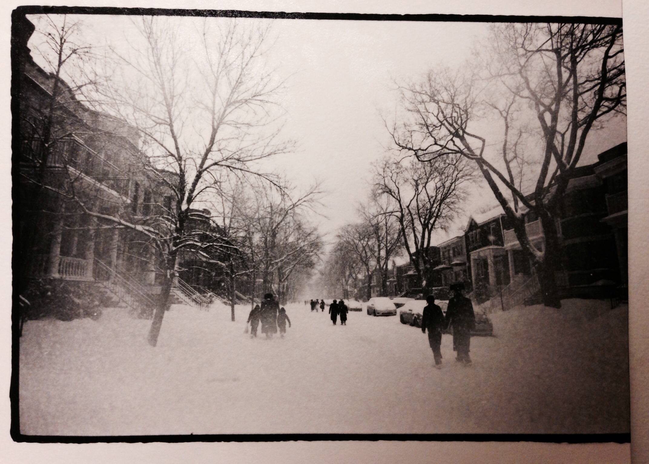

Washing is a huuuuge pita (puta?). But the paper ads enough to the image and feel that I think I can put up with the pita.
Nice shot! If you didn't have any cars in the scene you'd almost mistake it for a photo from 1919. JW
The only good thing is that in 30 years it will start to look good.
My 20 year old street shots with cars in them are starting to look good. Finally :smile: in 10 years they will have matured to full completion!
