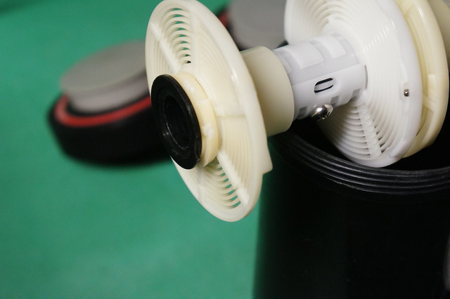

This is a Patterson System 4 Tank I purchased in the UK from Ebay. I cut down two of the reels so that only the central post and the end cap remained. The rest of the two reels were cut away and thrown out. I used self tapping stainless screws to secure the reels onto the rods squarely and strongly. The result is a trimmed down set of 70mm spaced reels, so I can run two 220 lengths at once. Also I can add a 35mm reel on the end so that helps as I always have a roll or two of 35mm to process.
