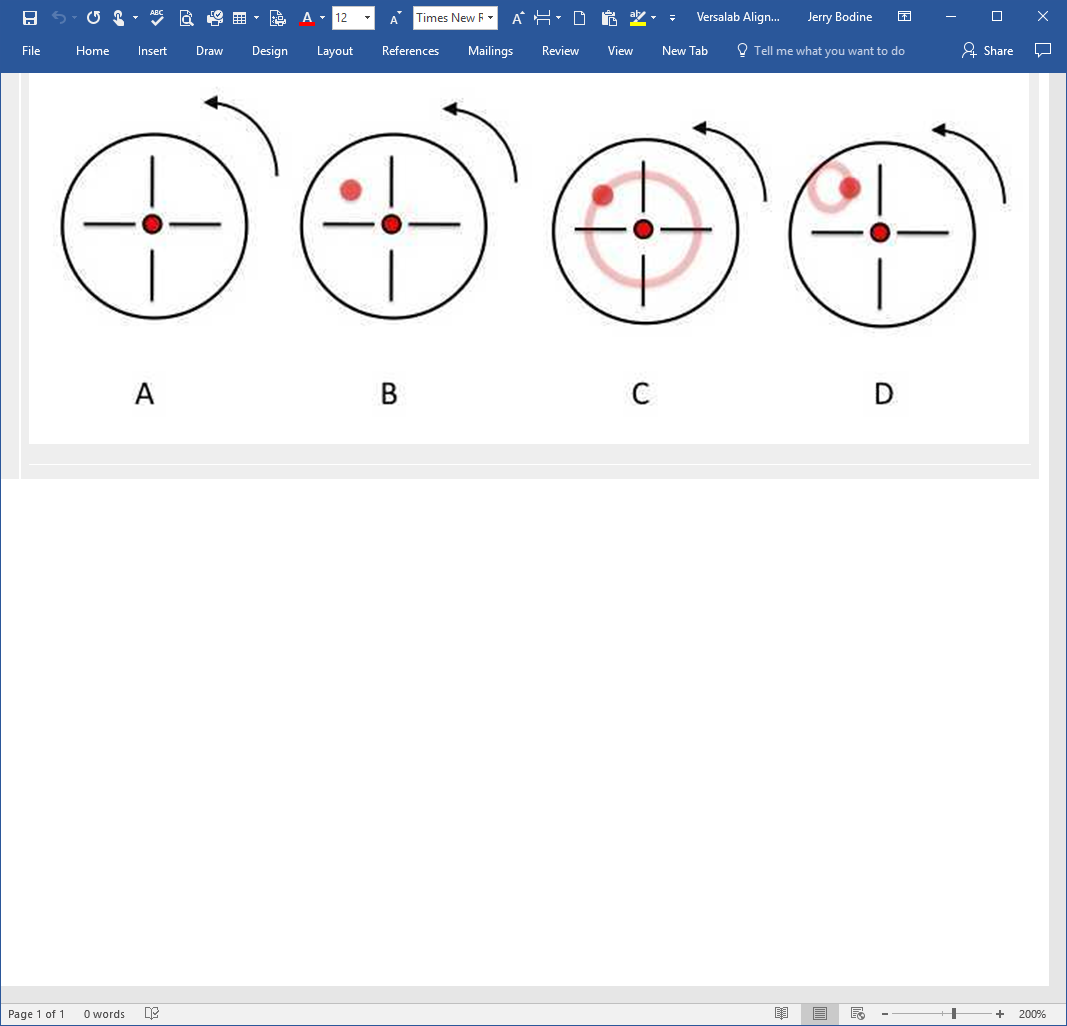

Nine years ago one of our members (ic-racer) posted some info about the Versalab device that I thought was so useful that I copied it to a MS Word document; glad I did because the illustration he attached has evaporated but it's preserved in Word so I've attached it here. I keep this info with my laser device. Here is the link to his post.
