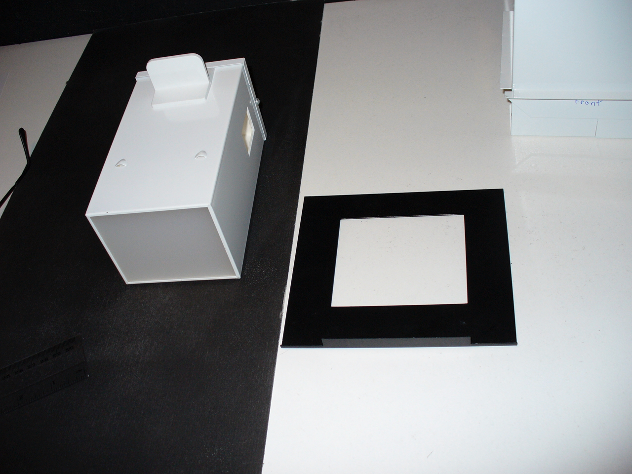

You not only need the adaptor plate for the Beseler 4x5 enlarger, but also the correct light mixing boxes. The boxes for the Beseler enlarger protrude about 2cm below the Ilford head so that the bottom of the box is just above the neg carrier. (By way of comparison, the boxes for the Durst L1200 are flush with the bottom of the Ilford head.)
Personally, I would only buy a working setup -- enlarger fitted with an Ilford head and with the matching mixing boxes (there are three: 4x5, 6x7 and 35mm).
Sorry, minor correction to my above comment. The mixing boxes for the Durst enlarger protrude about 1cm below the Ilford head, whereas the boxes for the Beseler enlarger protrude about 3cm below the head. Attached is a photo of the 6x7 mixing box and adaptor plate for the Beseler enlarger. The plate sits on the bottom of the head and the mixing box drops through the plate up to the lugs about 3cm from the base.
