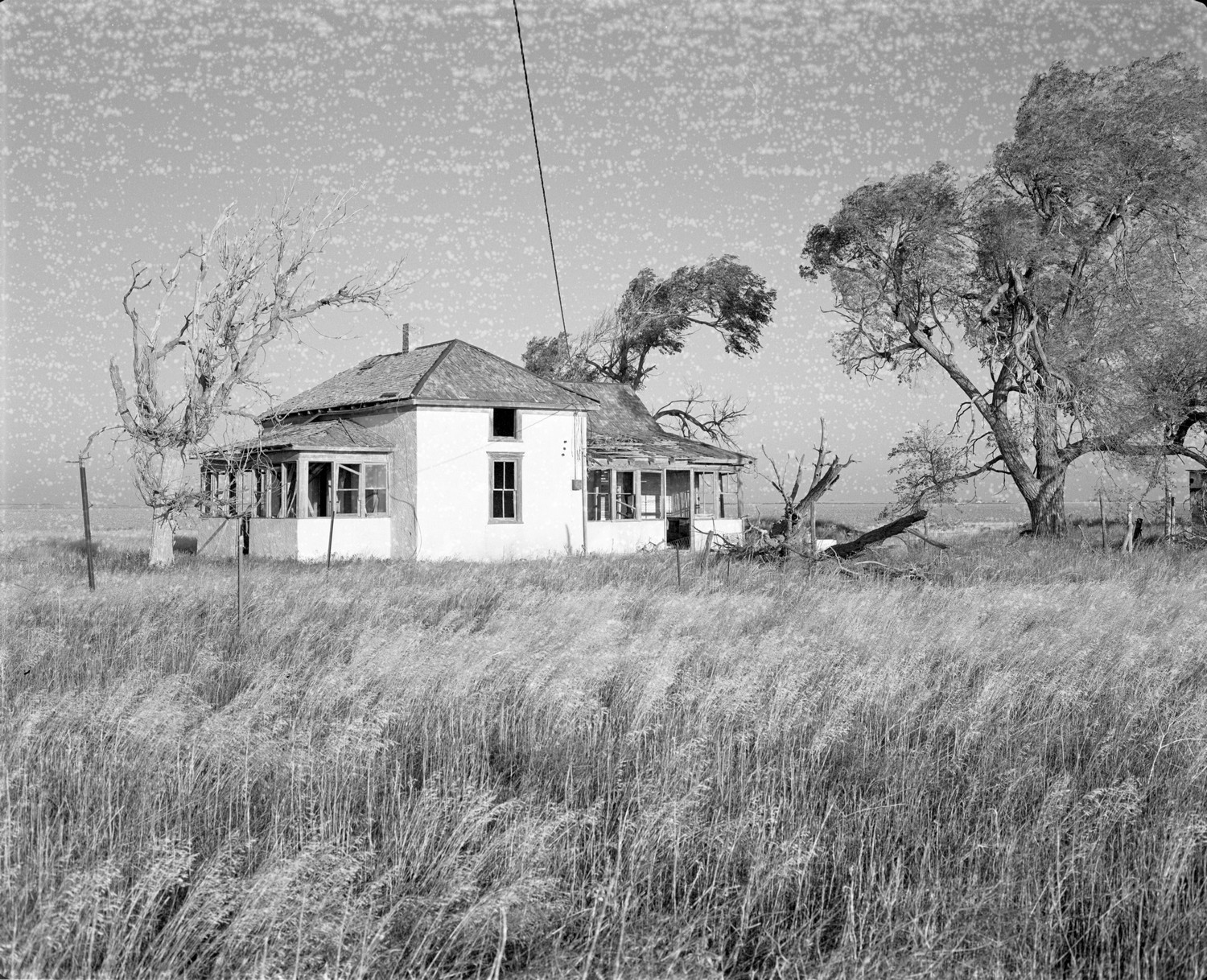

Hello everybody,
I have just shot a test roll of Delta 100 to test a new developer and got the unfortunate result you see as as attached. This is a crop of an image that shows the defect. The film is very fresh with an expiration date of June 2020. Here is what I did: The film was stored at room temperature. I put the roll inside my RZ67 and went outside, where the temperature is around 10° Celsius (or 50° Farenheit) and shot the roll in about 15 minutes and went back inside. I loaded the roll into my development tank immediately (hands got a bit sweaty) and developed as usual. Now I wonder if this defect is the result of manufacturing error, or if the film managed to get exposed to excess humidity due to my handling and the rapid changes in temperature I subjected it to. Also, since it was a test roll, I didn't keep the washing temperature at 20° Celsius (68°F) as I usually do, so the washing water was at around 14°C(57°F). Has anyone had similar artifacts or does anyone know if my mishandling of the film is likely to blame? Thanks!

Hey, op here. I had the same thing happen to me again with some Delta 100 and did some serious research into my process. I believe I have successfully eliminated it. I had shot outdoors at around 90% RH and 0°C, so I thought I had a condensation issue with some backing paper interaction at hand. So I tested again and put took the roll out of the camera while still outside in the cold and put it in a jar with some rice to absorb any humidity and let it warm up for 12 hrs. The exact same problem happened again, so I reexamined the roll and noticed the problem disappeared at a sharp point near the end of the roll, with a straight line of dots. It then dawned on me that my unspooling method probably was to blame: for some reason I had unspooled the film to remove the backing paper and then inserted it into the reel. The film hat thus touched its own backside. I then repeated the test in the same atmospheric conditions and purposefully subjected the film to a strong temperature shock and spooled it into the reel directly from the spool, avoiding that the film touches itself. It came out flawless. I should note it was from the exact same batch as the roll that had the problem yesterday. tl:dr: don't let the film touch its own backside. Should my future findings contradict this hypothesis I will post on this thread again.

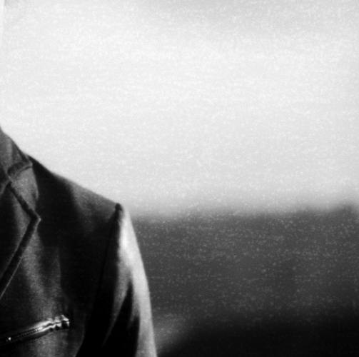

I had the same issue with a 120 roll of HP5+ that was left in the camera for a number of months. Upon the recommendation of members of this forum, I checked https://www.ilfordphoto.com/statement-120-roll-film/
I contacted Ilford and they are replacing the roll, not much of a consolation and I'd hate to have this happen again.

Thank you MC for starting this thread. The problems illustrated here look exactly like mine. I've had the problem with Delta 100 and FP4. I'd come to believe it was moisture from cold-hot cycles, including severe handling--my worst roll was one that I had clutched tightly in my warm sweaty hand for about half an hour after removing it from the camera (long story, basically I was trying to shield it from the sun before getting it into my cooler but on my way there got pulled into an unexpectedly long conversation with a stranger).
--I've been storing my film in a freezer and some rolls maybe have been pulled in and out of the freezer multiple times such as when I take out a roll and put it in my bag for an excursion, then don't use it and put it back in the freezer...but I never take any film out of the sealed wrapper until putting it into a camera.
--Your latest finding is especially interesting--suggesting the damage happens in the changing bag due to removing the backing paper before spooling the film onto the reel--I recently started doing that, too. I had thought this problem was caused by an interaction between the film and the backing paper, but maybe not?
--Then again, recently I shot two rolls of film, one from an older batch (exp. 2018) and one from a newer batch, handled them both the same way in the changing bag...the older roll had the speckling problem while the newer roll did not.
I'll be very interested to learn of any further findings from anybody!
At this point I don't trust any 120 b+w film in my freezer and I'd hate to throw it out.

Below is another image showing the problem. This roll of Delta 100
--was dated 2018;
--was in a freezer most of the time;
--was definitely taken out of the freezer, carried who knows where in a camera bag, and returned to the freezer at least once and probably multiple times over the past few years;
--was removed from its sealed pouch, loaded into the camera, shot, and processed within the same day
a few days ago;
--it shows the speckling problem.
I suspected this roll would be bad based on its history. I shot it to test whether a prewash would help--maybe whatever the backing paper did to the emulsion could be washed off? I shot all ten images of the same scene, cut the roll in half in the changing bag and developed the two halves separately, one with prewash, one without. Prewash (three minutes with periodic agitation) didn't make any difference. The whole roll was like this. Film travel was horizontal in the camera (Bessa III).
