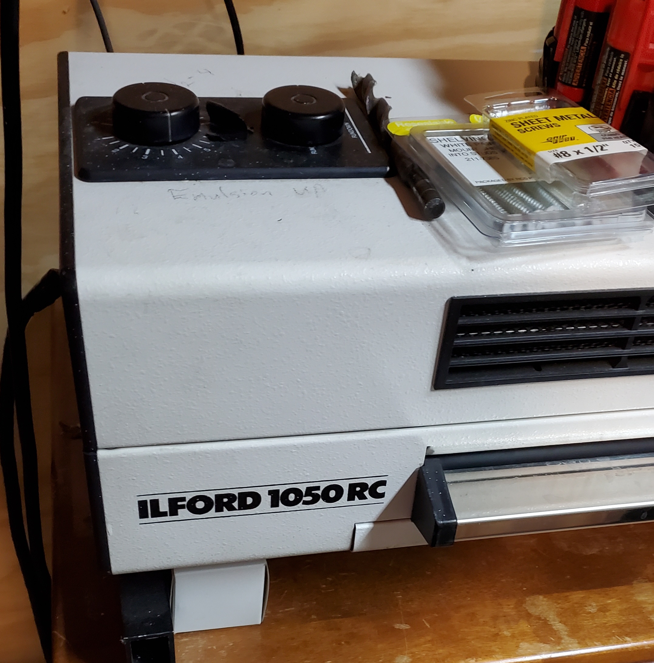

Hey all,
I'm home from college and working in my darkroom, and I've discovered that my Ilford 1050 RC print dryer will not heat up. I left it running for a while, and it didn't change temperature. Does anyone have any suggestions on what to do or what the problem might be? I'd rather get some insight before I start taking it apart myself.
Thanks!

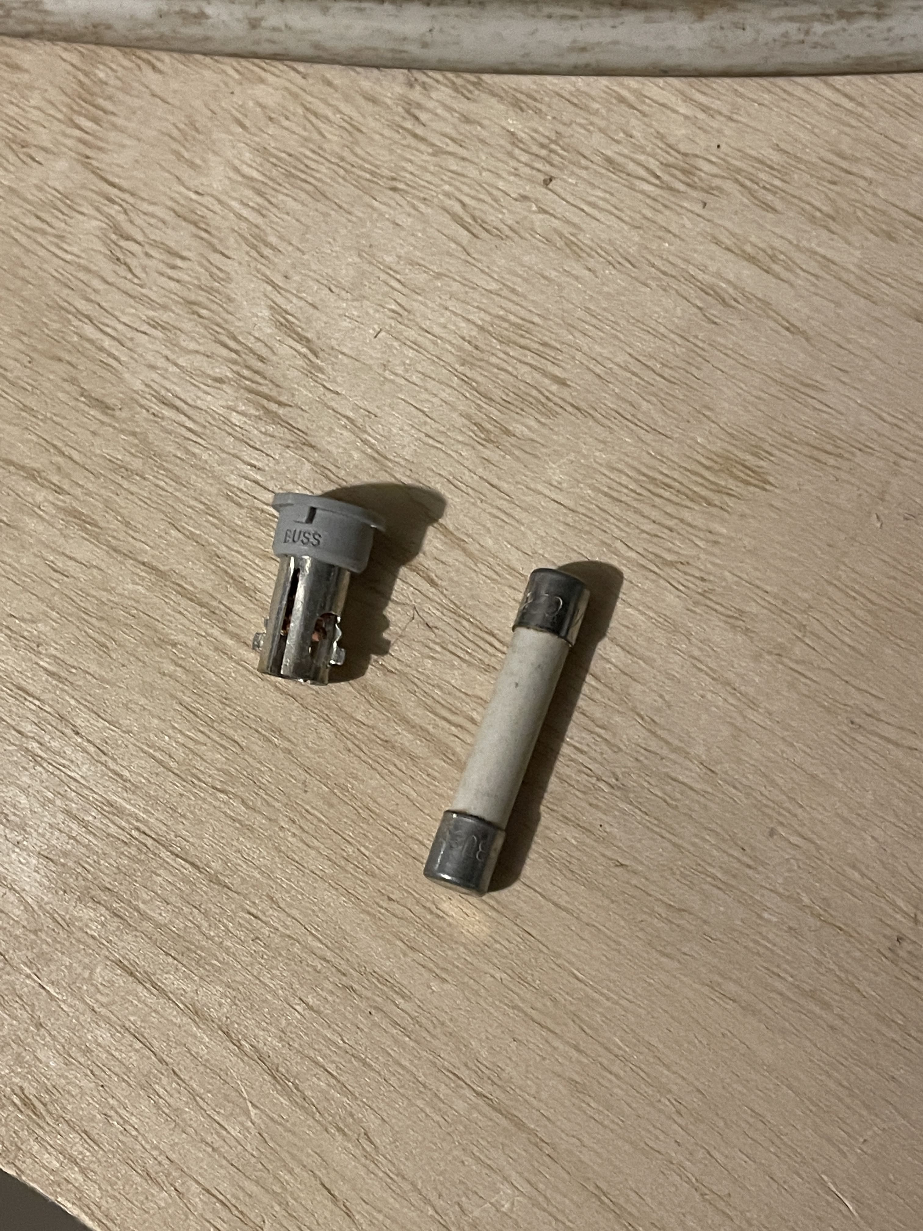

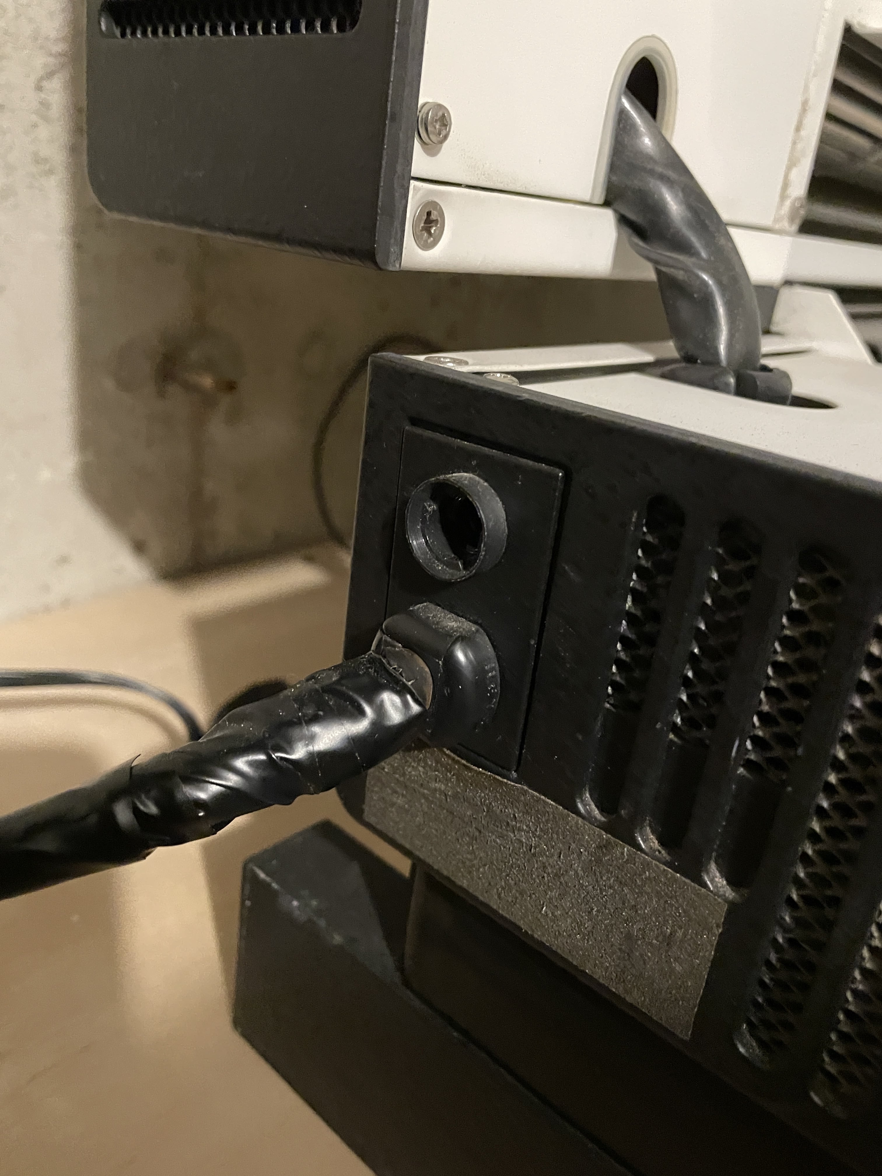

Did you check the fuse, located just above the power cord?

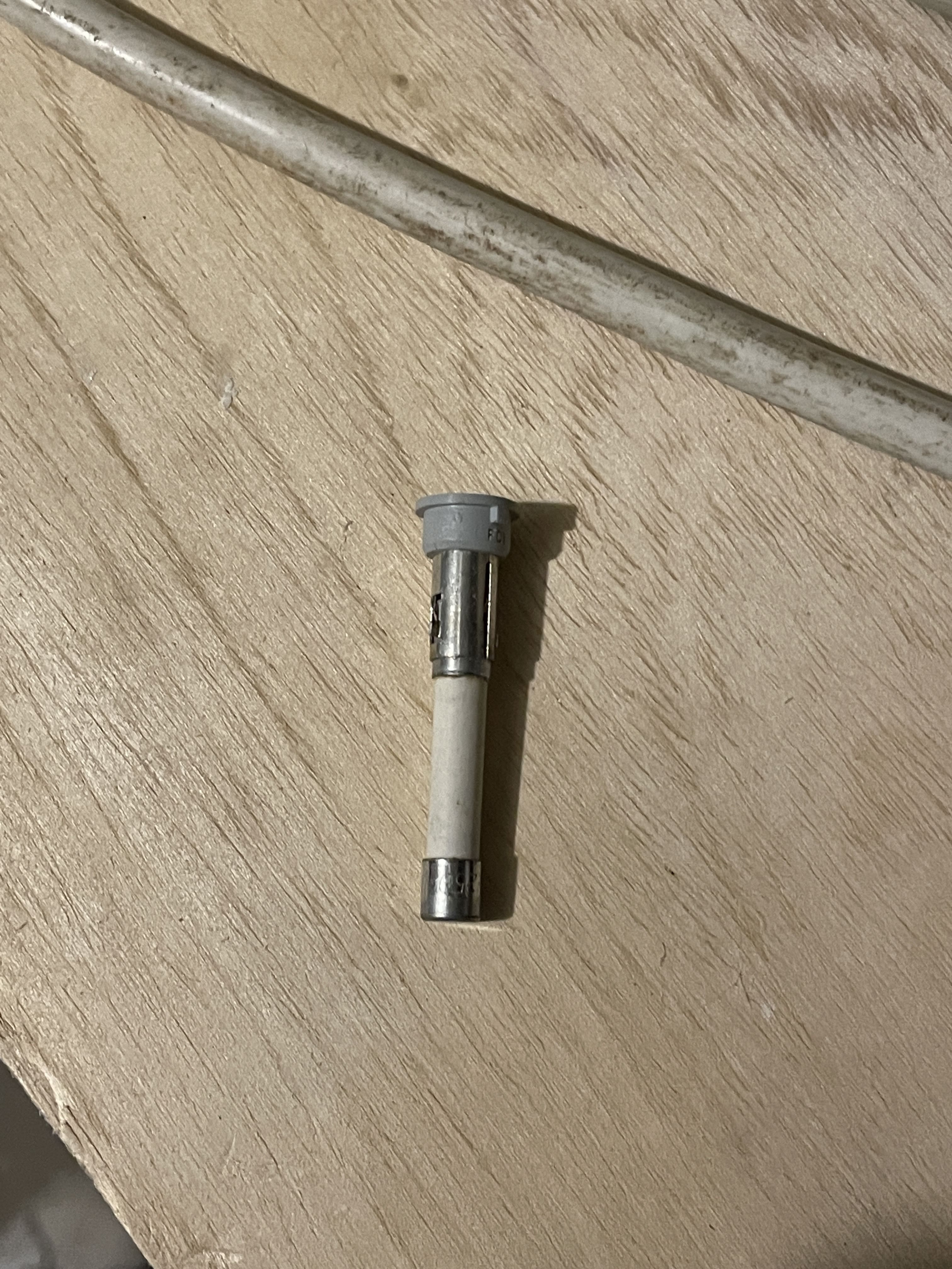

Here's the fuse. I don't really know what I am looking for here.
As mshchem recommends check the ohms reading (with a multimeter) between the two ends of the fuse. If the reading is 0 the fuse is good. If it’s bad the ohms will be infinity- an open circuit.
I think the fuse is blown. Shouldn't it be clear? I will try to get to the hardware store and get a replacement. The only thing I don't get is why everything else turns on and runs except the heating element if the fuse is blown. I'll start with the fuse and see if that changes anything.
Some fuses are clear- some, like yours, are not. I agree, spent a couple of bucks on a new one and see what happens. I have not a clue as to the internal circuits of the dryer, but it is not unusual for a big consumer, like the heating elements, to be fused separate from the rest of the machine.
I managed to get a replacement fuse (Bussman 250V), and it still doesn't heat up. I haven't heard back from Ilford; maybe they are still closed for the holidays.

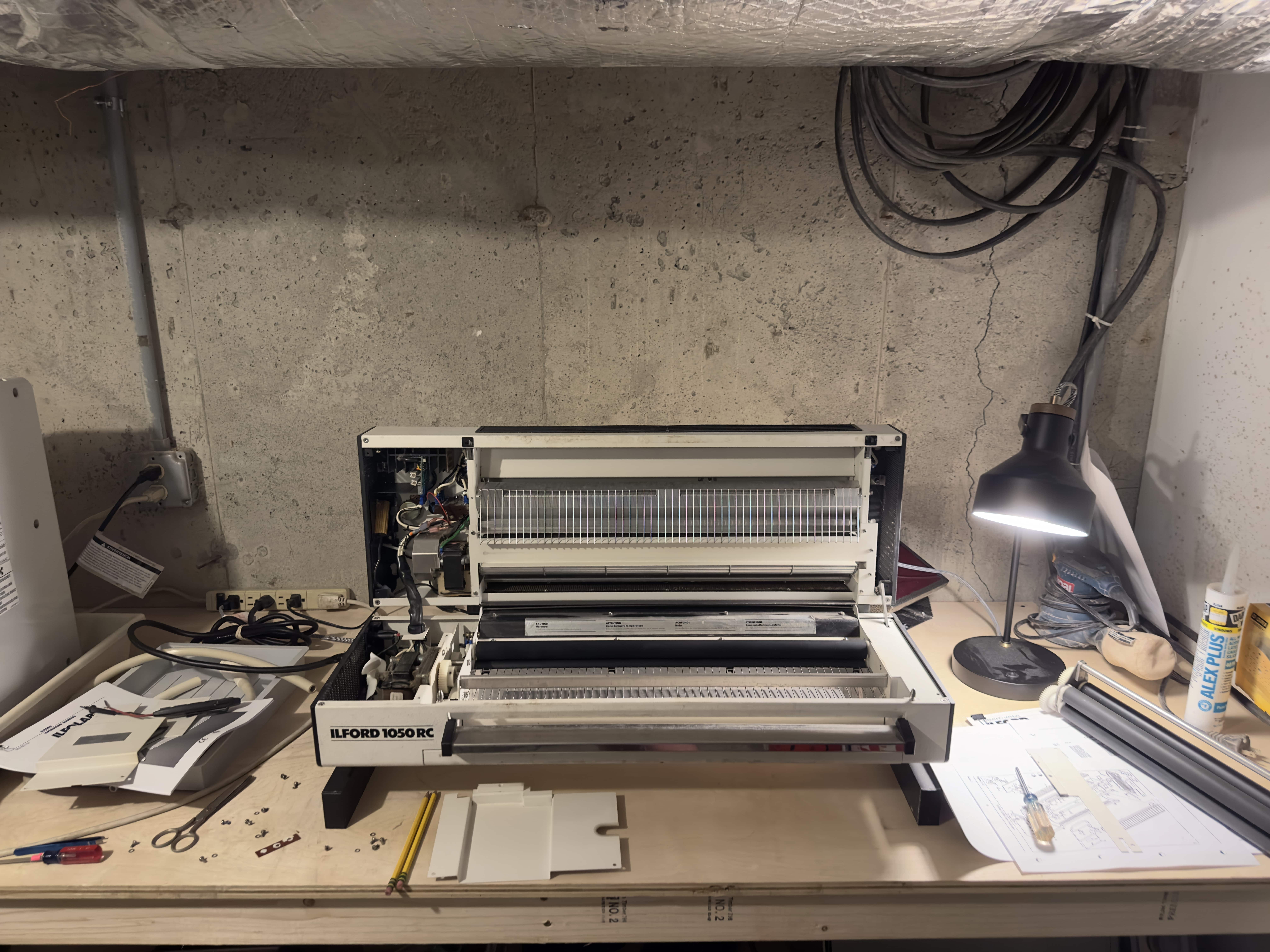

I took off a few of the cover panels on the inside to start inspecting the internal components. It's very dusty. I'm going to clean it and try to find the issue. I'm not the best with electrical work, but I'm determined to fix this.

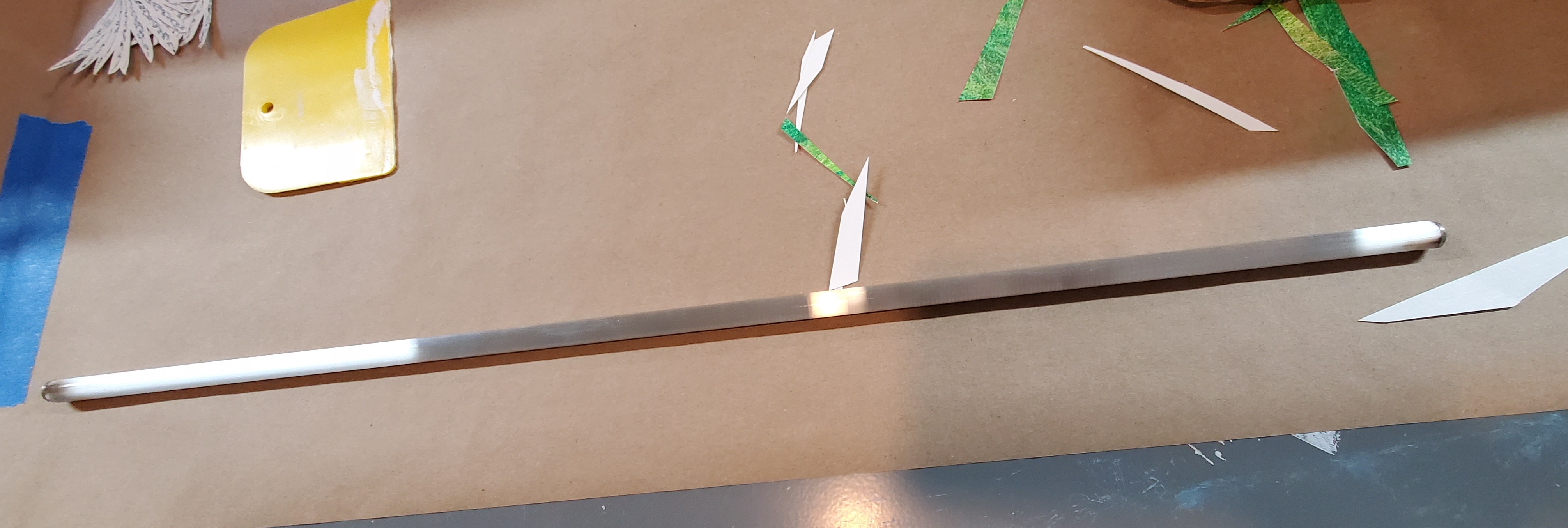

This is a replacement heater for the Ilford 2150 processor. Quartz/borosilicate? tube with a coiled wire heating element inside the tube. Pretty ordinary device. Again if I was having issues, I would UNPLUG,and check that each heater is seated properly, the connections are very clean and free of any corrosion or oxides. Then if cleaning doesn't help pull the heaters, miraculously not breaking them in the process, and check each element for continuity. And then 🤬
The white bands are just lighting, they look a bit like frosted glass.
Mine is still working, so there's still hope. Mine came from a storage unit clean out in Arizona IIRC. Note drill bits and screws from endlessly working on my darkroom 😂
Yes, that's the same as what I see in mine. I assume they are replaceable if that's truly the issue? It's weird for both of them in mine to break at the same time, which is why I'm starting to think the cause might not be the heater itself but something else. I will keep investigating. It's def 😡. These machines are rare these days.
