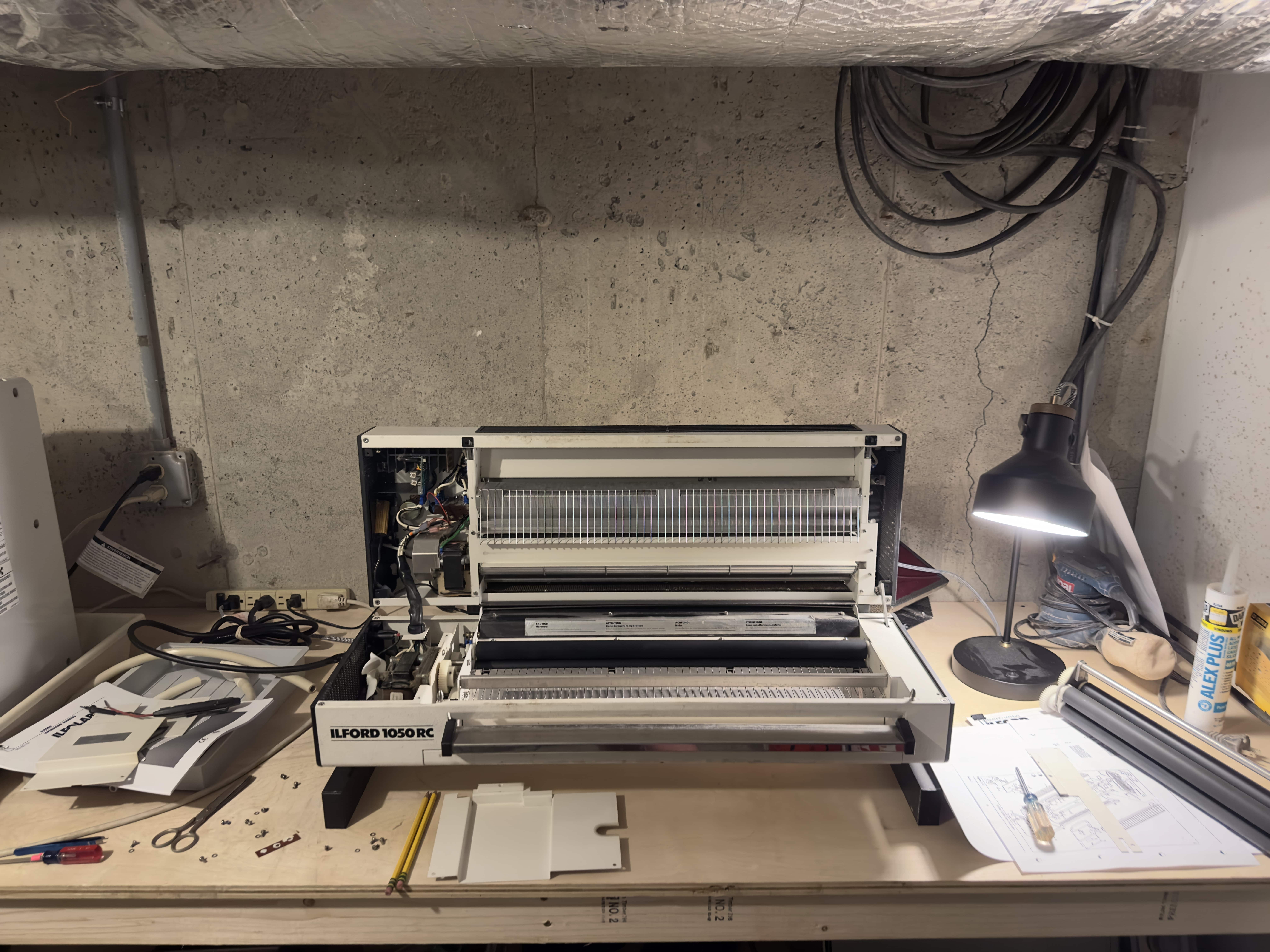

This is mine currently.
That's a nice one. I would wager that you have corrosion on the heater ends. Just a basic connection current flows from on end to the other ( well in layman's terms) Again unplug the thing and go buy a cheap multimeter. You don't need power to check the heaters.

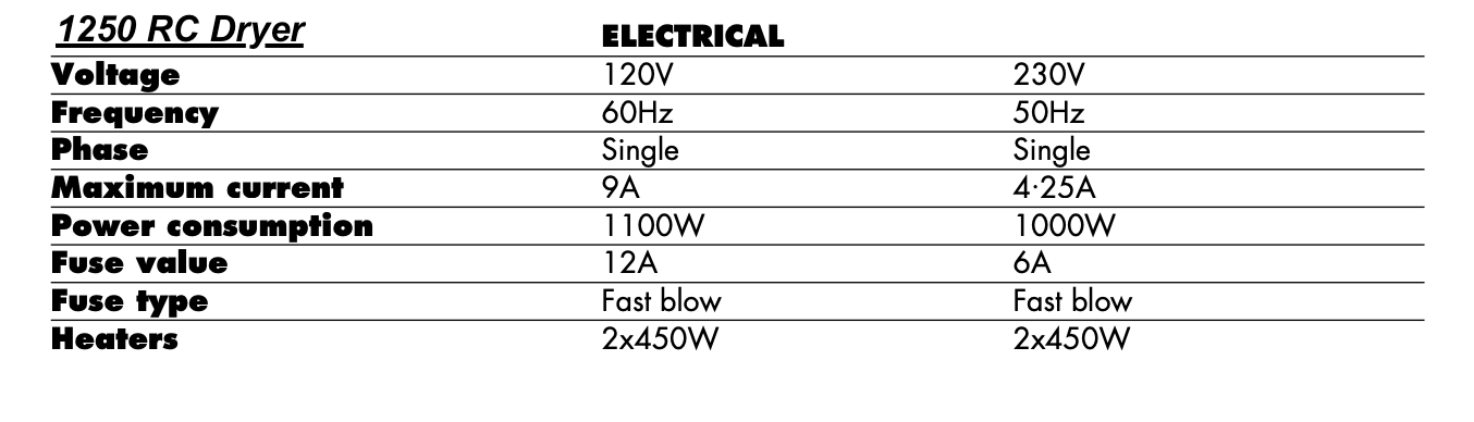

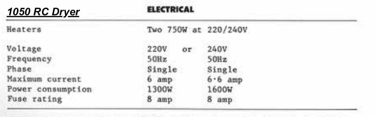

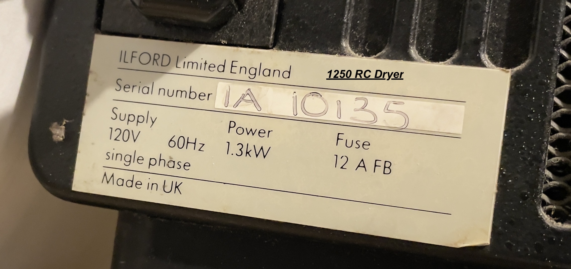

I don't think so, the 1250 dryer takes two 450W heaters, and the 1050 dryer takes two 750W heaters— this is according to their respective manuals.
Also, the manuals list two separate voltages for both models, and from how I'm reading it, that means that there are two different versions of each model. Is it possible that the 1050 isn't heating up because it's not getting the right voltage? The power supply in my house 120V in each outlet. Maybe this is a stupid idea.
