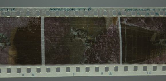

This would suggest that the film was similar to Agfa CN17, which had no orange mask. In 1963 it became CN17M which had the orange mask but it didn't last long on the market.
Here is a sample (not good quality) of the maskless CN17.

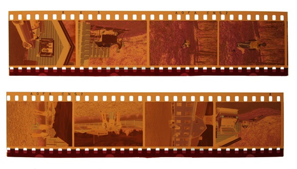

In 1968 Agfa CNS became available and it had the orange mask. I'm not sure if Ilford continued with the Agfa type film at this time.
Here is a sample of the Agfa CNS orange masked film.
