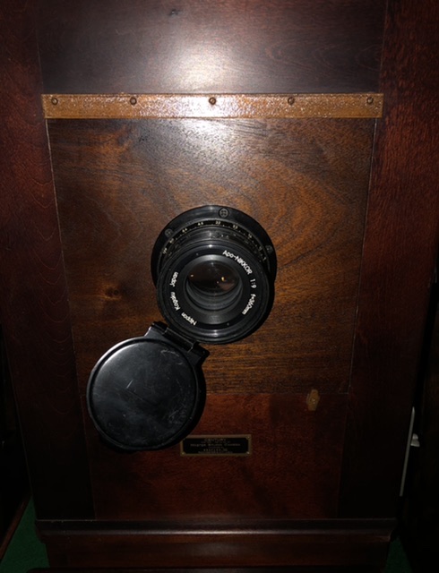

I’m plainly searching for technical information. Can’t wait to test it. Still on its way. Most likely will cover it. I have a 360mm nikon process lens with a 600mm coverage on my Century Master. ECBDFA66-2F91-4722-848E-AA160ED56FAC.jpeg
Are you sure? I ask because the catalog says that it covers 46 degrees. At infinity that means 305 mm. Might you be reporting coverage at 1:1?
