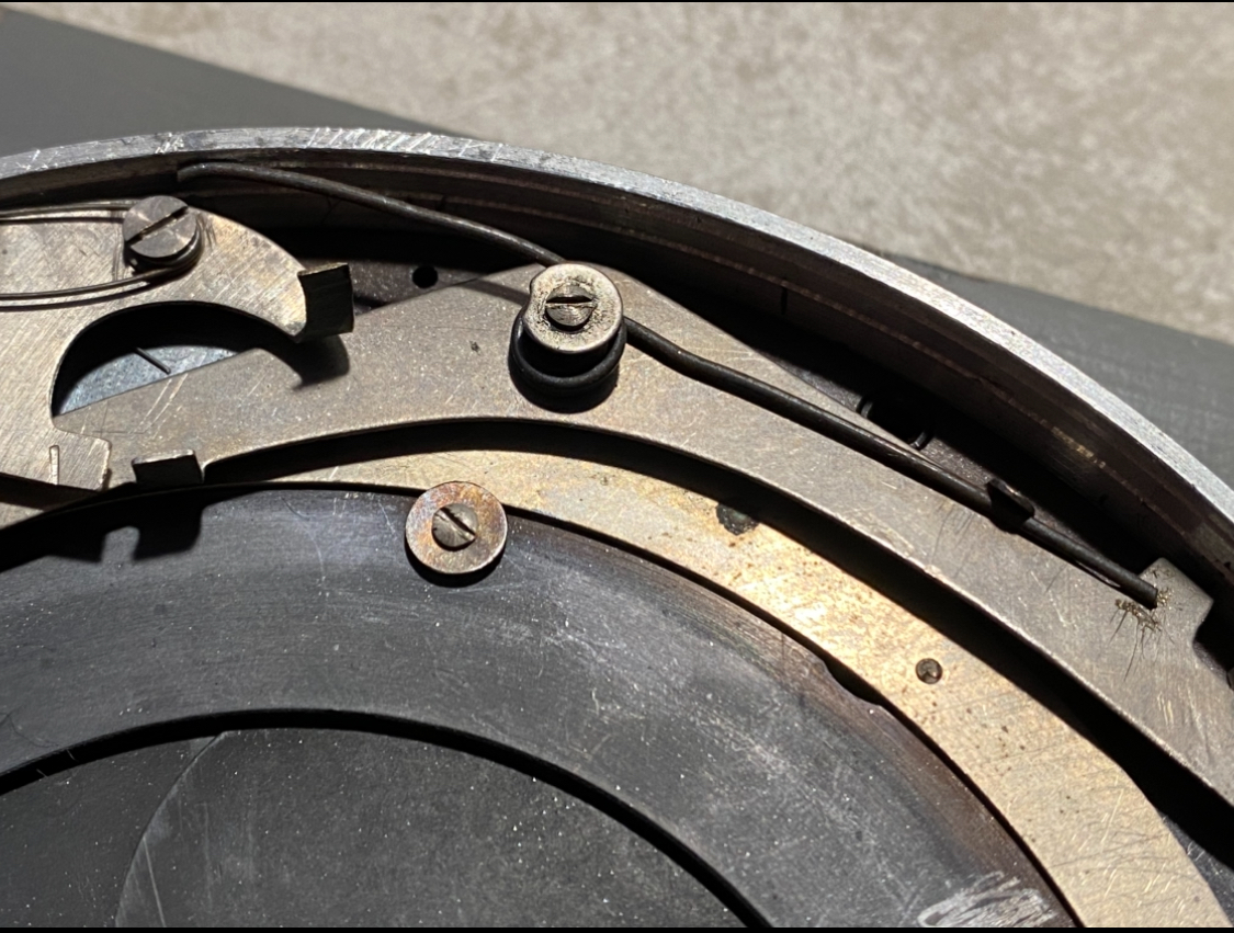

Today I looked at a lens for sale. It’s in an Ilex #5 shutter, and the blades are sluggish on the closing action. It seems to work fine otherwise, but it doesn’t reach anywhere near its 1/50th max speed.
Now I happen to be handy enough, so I looked inside my own Kodak 12” f4.5 with the same shutter. It appears - appears… - that a thick piano wire spring may be responsible for snapping the blades shut. Can anyone here confirm whether it is in fact the spring shown below? Seems like a relatively easy repair.

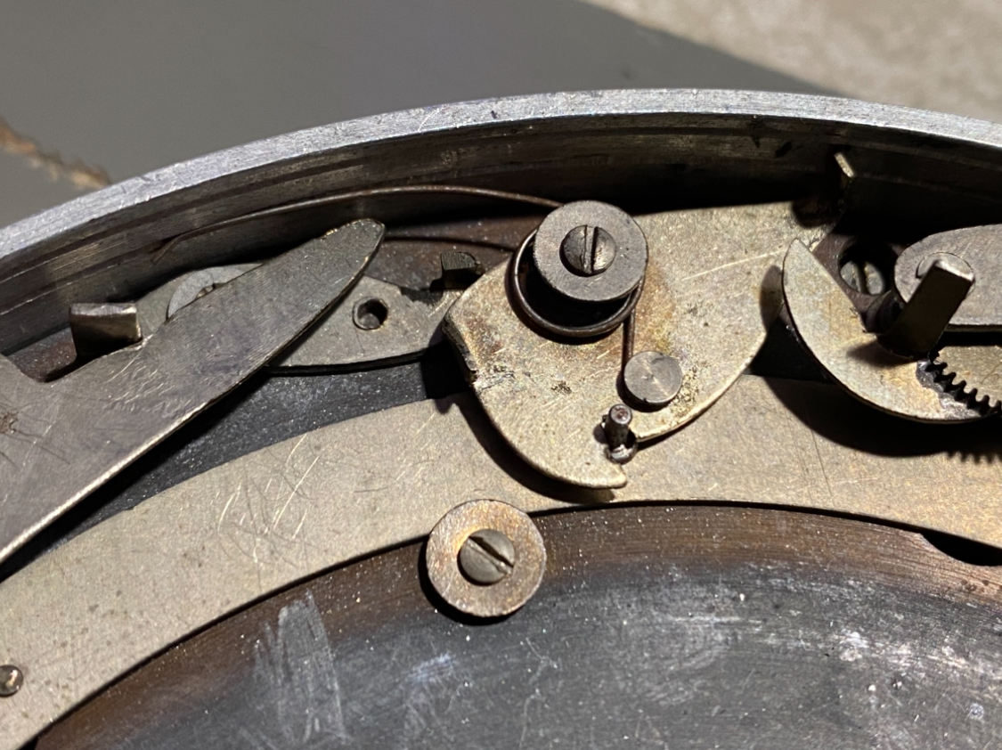

You know, I really should get my prescription updated. Turns out it’s a smaller spring a few inches away. Even better, BTW, as it’s within the size of a thick unwound guitar string. They make great springs.
The spring in the top photo is no good. I would not buy this shutter. Guitar strings make FAIR springs, Not good ones.
Just to clarify, the pictures are of my working shutter which I opened up for reference. The blades on this one are snappy and quick to move.
