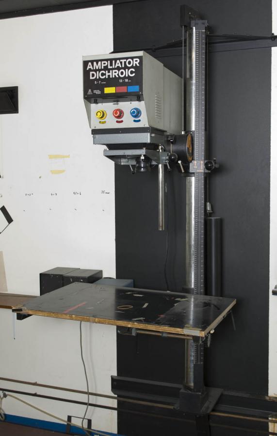

Anyone here who has used IFF enlargers? The model in question is Ampliator, and now I've got a photo of it.

we have got - as a present (!!) a huge Ampliator 13x18...
I didn't realize it was an IFF (is yours from Firenze?... sorry - just read your post again..and you mention Florenze.)
if so - ours is - looking at your image - somewhat newer, but with a "normal" B/W head on it.
it is HUGE and I think it weighs at least twice or the tripple of what a Durst 13x18 does!!
Mounting that on a wall sounds crazy to me..
That said - it is a VERY easy enlarger to work with! The negative holder is much easier than the one on my Durst, and the focusing - changing of lenses - changing of condensors are all "fool proof"..
A joy to use!
PS: as an owner of both - I really like to work with the Durst, but must admit, the Ampliator is much easier...

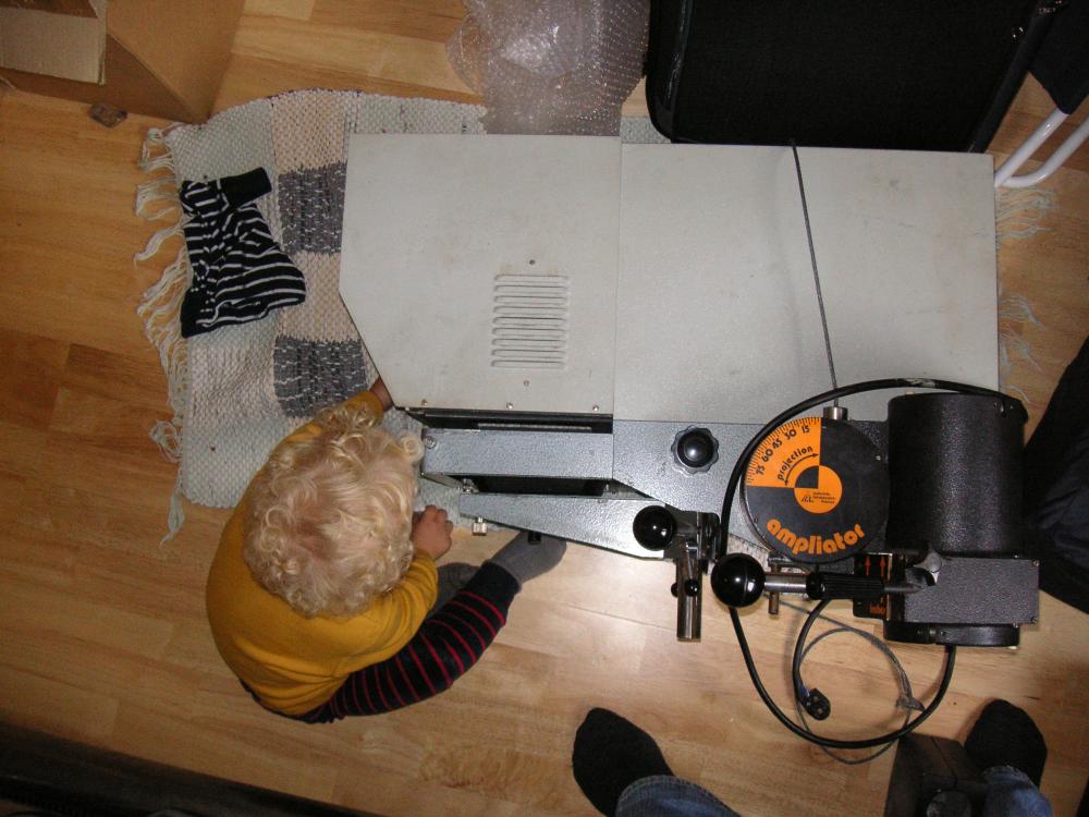

I've just carried the Ampliator, in parts, up the stairs to our flat. The enlarger has been modified by the previous owner. The counterweight is placed outside the column, so it was very easy to disengage.
Attached is a digisnap of the enlarger and my son ;-).

I have examined the enlarger more closely. There is a bit rust here and there, but it doesn't seem to matter for the operation of the enlarger. It was very dirty, and I have cleaned the exterior and the inside of the colour head.
Some felt in the light traps will have to be replaced here and there.
The previous owner was obviously fond of tape, it will take some work to remove all of it from the baseboard.
The enlarger powers up fine and the fan, the lamps and the filters work fine. The fan is quite noisy though.
One interesting thing is that the colour head is located in the front of the enlarger. The large rear part of the head is actually a lamp house for when the enlarger is used with condensors. It contains a turret with three lamp sockets, one of them occupied by a large opal lamp. That part of the enlarger has probably never been used, and I don't have the condensors
Will post more photos later today.
