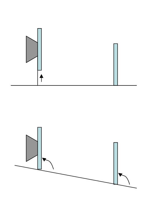

Alan, kind of. Incline the camera's bed, use tilt to make both standards vertical and Bob's your uncle. Draw a sketch ...
My little Graphics have beds that drop and front standards with rear tilt and rise. Level camera, drop bed, make standard (on the outer bed, of course) vertical and there you are. Except that the things have limited front rise and the farther out the front standard is on the rail the lower the neutral position is. Can't count on getting the front fall you want. Nice idea, practical with a narrow range of focal lengths and focused distances. Sometimes you just can't win.

I was just joking with you, Dan. Bob explained it to me but thanks. I get it now.
Yeah, I think Bob would make an excellent uncle. :smile:

Kind of like indirect fall?
I mentioned on LFPF that the Wista metal cameras have no front fall but generous rise. Someone mentioned dropping the bed to get fall. :D
No difference in end result
Thanks. I was thinking that on the Wista if you drop your bed then you have to adjust your tripod head to match which would be another step. No biggie for landscape photography but a pain if you just wanted a little front fall for a portrait.
Bob mentioned that you can start out with some front rise on the Wista. Then you would have the choice of rise or fall when shooting a portrait.
nice diagram !
i implied that there was any difference i just suggested it might be fun to teach/show.
... definately more fun than turning a knob, which, even though it does the same thing, is kind of boring ... :smile:
