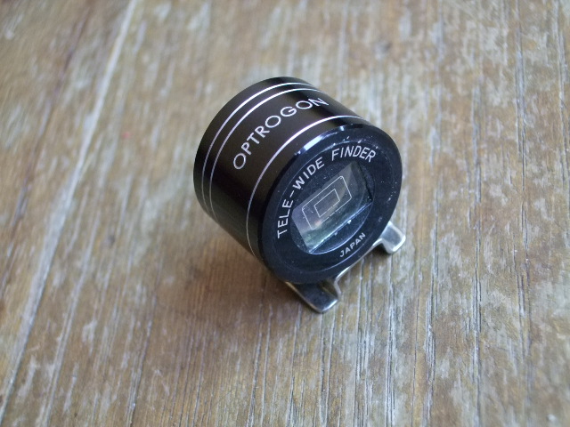

Many plastic P&S have a zoom starting at 38mm, close enough to 40, but possibly their v/f only shows 80% or less?
Then there is a model of Albada v/f (reflected framelines) that came with the wide/tele add-ons of Yashica cameras. I've seen it under various names.
Not sure whether "wide" frame is 40 or 35mm, but IMO close enough that one might perform the small correction mentally.

Voigtländer made two kinds of accessory finders, the Kontur one and that swivelling one.
