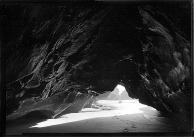

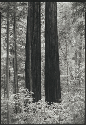

Unfortunately, most of my photographing situations seem to make the use of front tilt null and void...and the longer lenses for "normal" focal lengths on 8x10 do not have a ton of DoF.
Here are two examples (5x7 with a 210mm lens). On neither one would front tilt have been of any use.
The one of the left is a carbon print, the one on the right is a platinum/palladium print.
