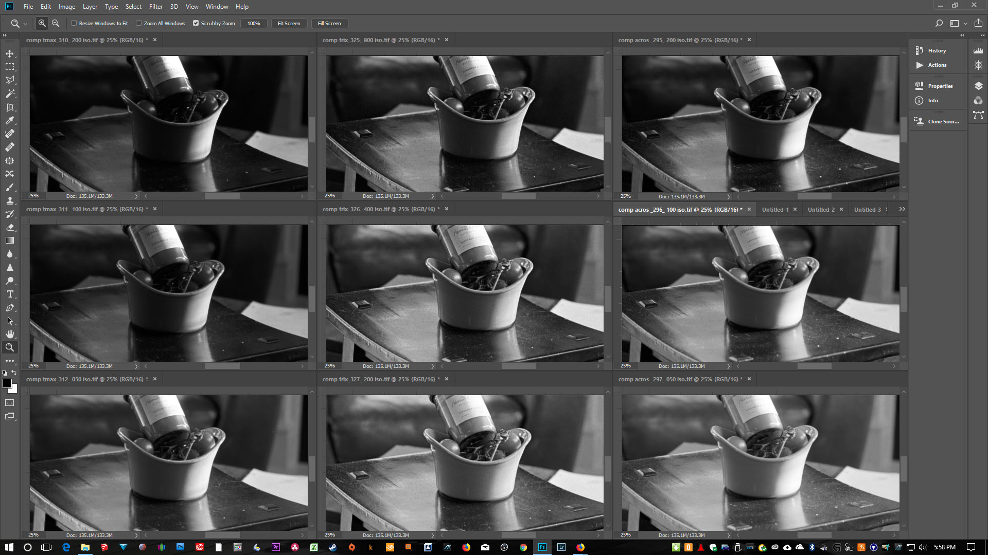

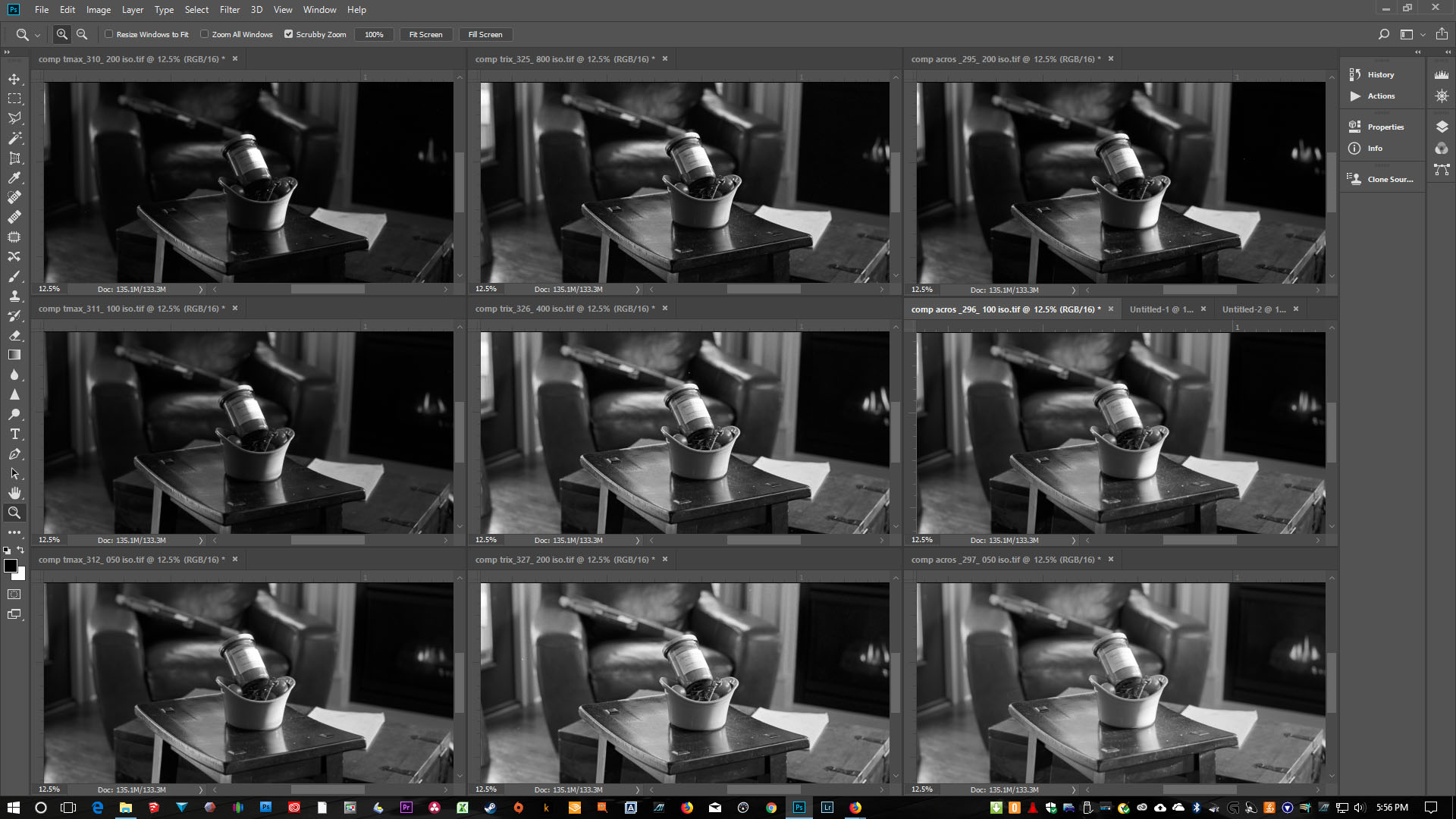

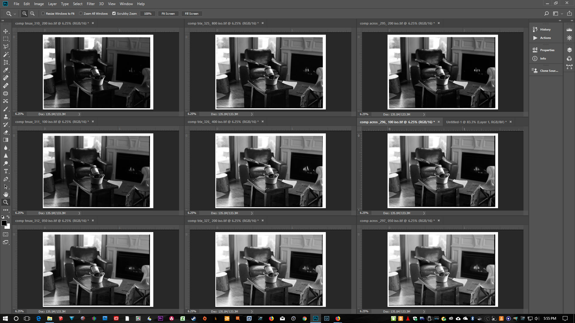

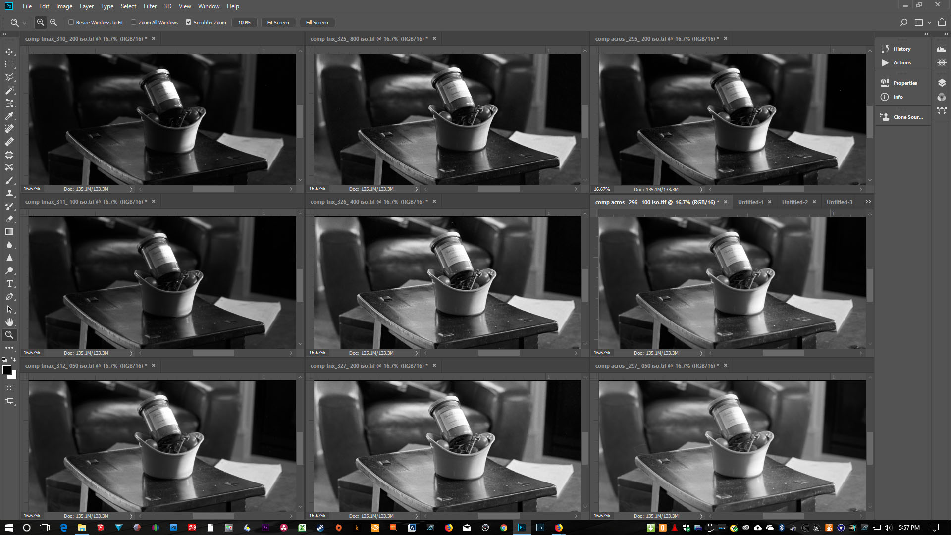

Here are some unedited scans side by side with the Coolscan 9000 of Tmas, Trix and Acros. Exposed at -1,0,1.
All shot with identical cameras, same lens and mounted on the same tripod.
I posted just a set of one test, unedited.
Tmax is not muddy. It is just muddy in comparison to Trix and Acros. It lacks ambience, contrast in the midtones and acutance (all relative to the other films).
