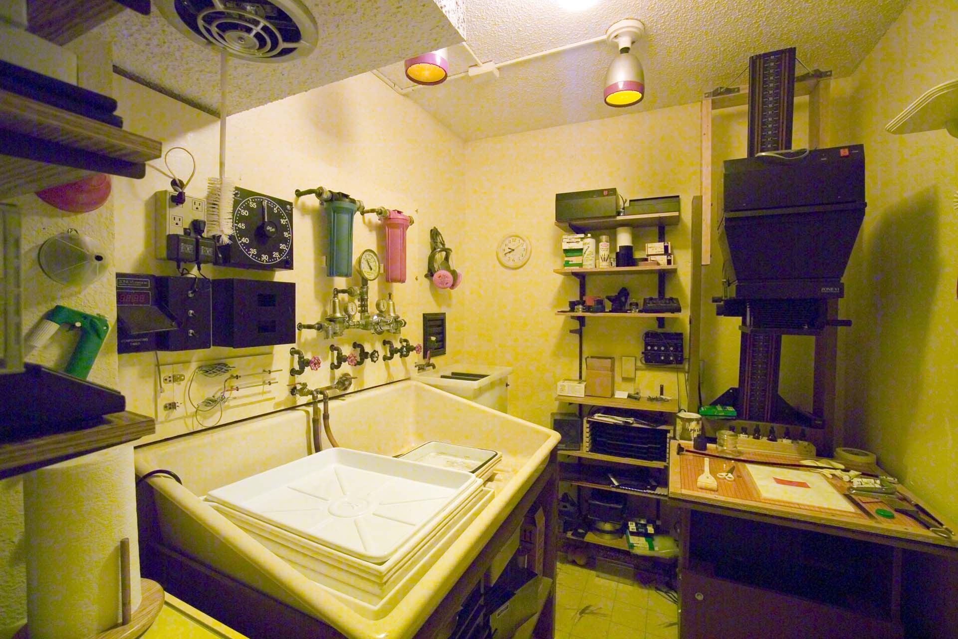

My darkroom is the same width, but a little longer (8ft) than the dimensions that you've discussed. I can do all kinds of different activities in my darkroom.
So, here's a layout that could work. (See photo.)
My Versalab 11x14 print washer is just beyond the sink on the left side. On the right, my enlarger is mounted on one of my particle board masterpieces. (Not all particle board, though.) The stand includes a 1 ft section that can be removed to lower the table for greater enlargements. It doesn't hurt, that I have a 9 ft ceiling.
I recommend the Delta 1, "The Sink" seen on the left. Works great. Mine is 4ft; but, it also comes in a 6ft version, which would be better for your purposes. I plan to replace mine with the longer version. But the dimensions of my darkroom will require that I remove the shelf seen to the left of my enlarger. You mentioned that you can make your darkroom longer. Good idea; it will enable you to keep a handy shelf next to the enlarger.
All my plumbing and electrical is on the left wall. (Obviously.) What's not so obvious is that it's all mounted on a half-inch sheet of plywood that itself has been mounted to the wall on two vertical 2"X2"'s. It connects via a single plug and two hoses (hot and cold). When we move from our home, it moves with me . . . intact.
Hope this gives you some ideas.

The sink has a rear set down trough and all drains to the back corner.
Should I make some 1/4" slats for the sink floor so trays don't suck to the sink floor?
Have enough ply to make an enlarger bench.
Still got to wet seal, do the plumbing, run some power, sheet the walls, tile the etc etc but its a start.
