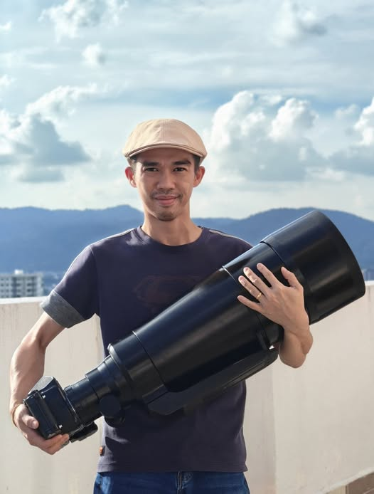

All are toys when you consider the 800mm f4.0 (four!) from Pentax,
which would give an angle of view and depth of field more or less similar than a 400mm f1.7 lens on full frame 35mm.

I think they used those during our American Civil War too, but mounted on wheels and stuffed with a cannon ball and powder. Nearly as loud as a Pentax 6x7 mirror slap, at least.

The photo shows that even large lenses can be portable.
All equipment is portable as long as you only need to move it a couple of steps.
