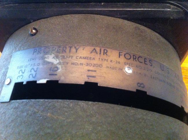

I stumbled upon this aircraft camera at a thrift store for $20 and had to have it. Identifying the exact model is proving difficult. The lens shade identifies it as a model K-24 aircraft camera, however no k-24's i've found resemble this thing. I do know that it's a 5x7, and that it's got a 300mm f/5 Kodak Aerostigmat lens. The camera weighs about 25 pounds, and is 2 feet long. It seems to be made out of fiberglass with metal and wood elements. The film holder has a "Thomas Airviews" logo stamped onto it, and the shutter mechanism (which is removable) is covered in what I assume are Japanese characters. Here are some iphone images of the camera. Does anyone have information about it?

The lens cone (not shade) is from a K-24. The K-24 shot 4.5" x 4.5" on 5" roll film.
Your camera is probably a home brew. Real aerial cameras are usually all metal.
By the time the K-24 was in use (WW-II) aerial cameras shot roll film. The sizes most commonly used by USAF were 5" (images 4.5" x 4.5") and 10" (images 9" x 9"). No 5x7. Did you measure correctly?
The 12"/5 Aerostigmat was designed sometime in the 1930s, is rated to cover 5" x 5" and isn't highly respected.

The writing is indeed Japanese, apparently having to do with a heater control and perhaps shutter controls. I don't recognize the logo with the stylized five petal cherry blossom containing the Japanese character for the figure 6. The camera is almost certainly a hodgepodge of several parts. I paid a lot more for just a lens like that with its lens cone.

Couple hundred $, if that . The lens is not highly sought after, the rest is just a paperweight. sad but true.
