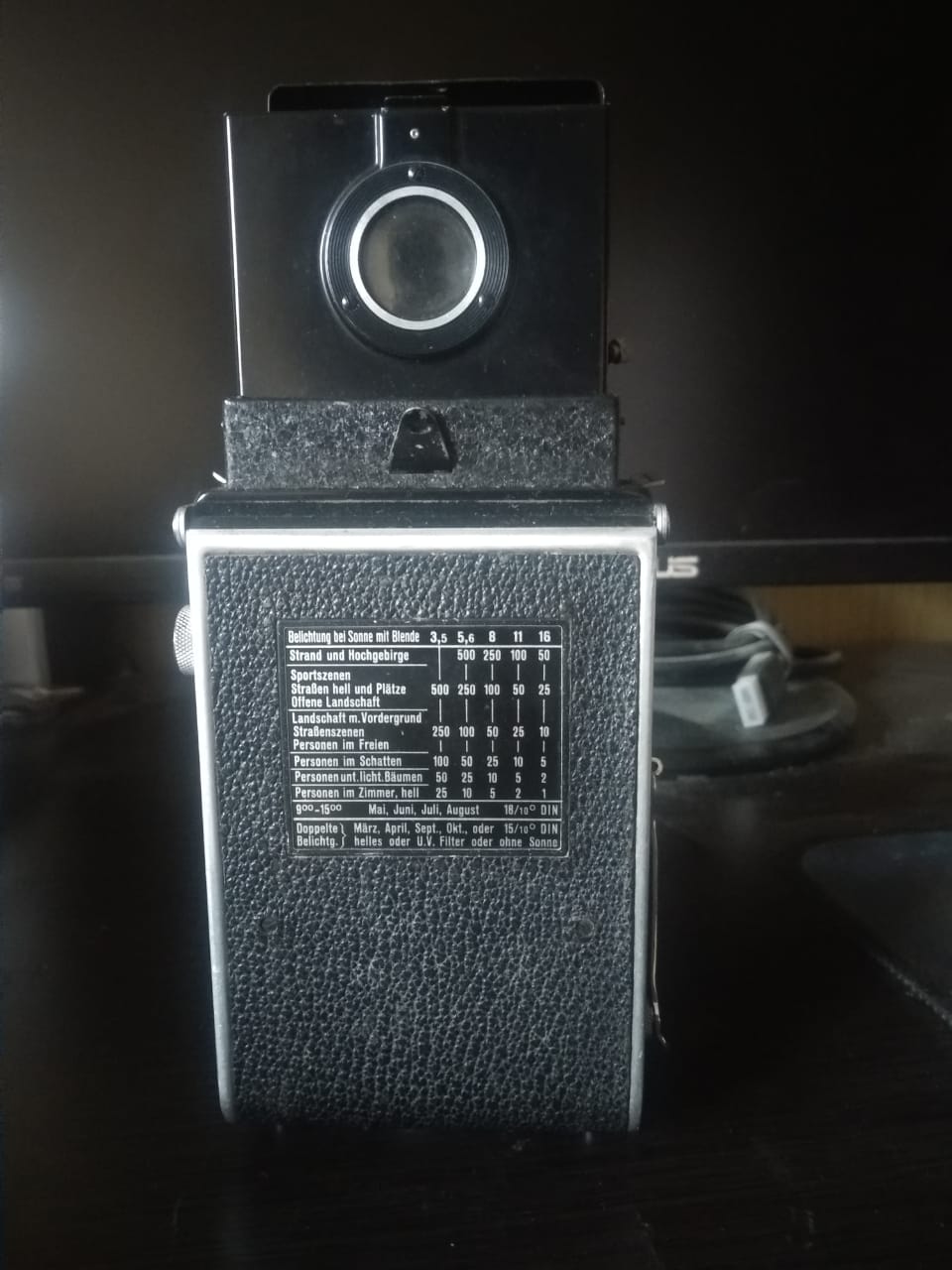

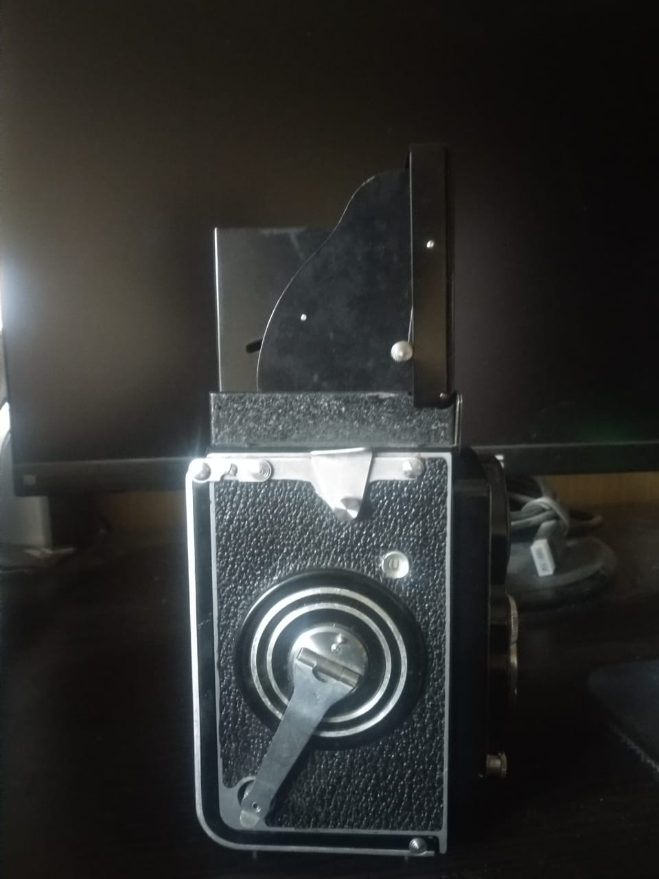

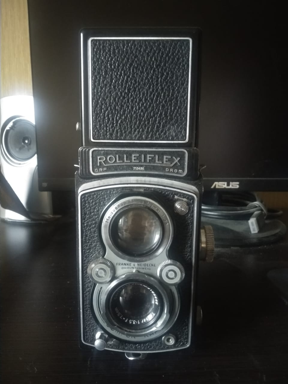

DRP and DRGM are just indicators that parts of a product are protected on their intellectual property. That the respective institution was a german imperial one, gives a certain hint at the period of installment of protection.
Pre-War Automat. K3A? The lack of a bayonet for filters on the viewing/upper lens, and the gray paint in the center rings of the shutter and aperture dials. Also no sports finder window on the focusing hood.
http://www.rolleiclub.com/cameras/tlr/info/automat.shtml
DRG and DRGM are trademark/patent marks, as noted. Deutsches Reich... By 1949, the mark was changed to DBG and DBGM, Deutsch Bundes. Germany changed its official title after WWII from Reich to Bundes... I'll let a real German speaker explain the difference in the two words.
https://www.acronymfinder.com/Deuts...an:-German-Federal-Utility-Model)-(DBGM).html
The first Rolleiflex Automat didn't have the protection cover for the shutter release button, but it was added a couple of months later. In 1939 the viewing lens also got a bayonet. So I would date this particular camera to 1938. The looks like it has been used, but the owner(s) took good care of it. :smile:

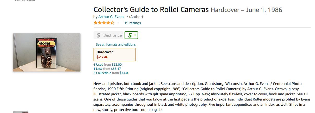

Could someone please tell me what is the title of the Arthur Evans book?
Thankyou.
I have missed something here.
Thankyou.
Screen shot from Amazon.... Looks like there are multiple sources. ISBN 0-931838-06-1
