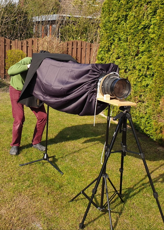

I build this 11x14ish Ulf Camera. Im Shooting with ra4 paper reversed. I went out yesterday to test it out i quickly realised that i need a good shutter for it. I thought the low sensitivity of the paper would be enough to slow down exposures down to seconds. Appearently It does not and i needed something like 1/10 of a second to take a well exposed image. I tried to manually do that but the paper was totally overexposed. So does anybody have an Idea how to build a good enogh shutter for this 20cm lense?

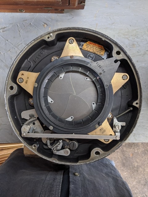

Strange, on the Etsy listing I can see the shutter blades and iris clearly in the 5th and 6th images there. Can you post a photo of your lens? Here is a photo of mine disassembled -
Oh what a beauty, this looks so good.
As you may see, i got the beautiful outside, but on the insdie its icecold
