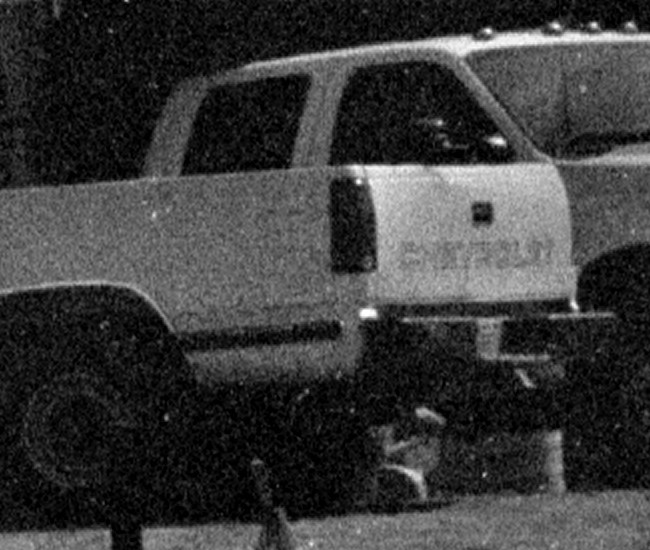

Perhaps Cooke triplets do better at this than Tessars, but I have a 105mm f/6.3 Agnar that I took off an otherwise non-functional folder and mounted on a board for my 4x5 Pacemaker Speed Graphic. Stopped down to f/11 or smaller, and (bellows) focused to hyperfocal distance (around 12 feet), it not only covers the corners, but has good enough resolution to read a license plate a block away. But no, not an enlarging/copy lens, by any stretch.

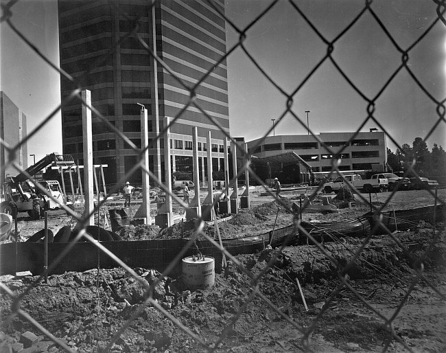

I will when I can either get some film or develop some of my plates from Jason Lane (got developers, need to order fixer). I agree with what several people have said in this thread, that the vignetting will probably be bad. Sharpness at infinity doesn't look much worse than my scratched and decoated Optar 135mm, but on the nasty old GG on my Speed Graphic that's not saying much, and anyways that Optar is far from in its prime. A moderate crop might be in order to take care of the vignetting.
It might, honestly, be nicest for portraits, since it seems to give a classic "swirly" bokeh at even middle apertures. I also like that it literally has a built-in lens hood!
