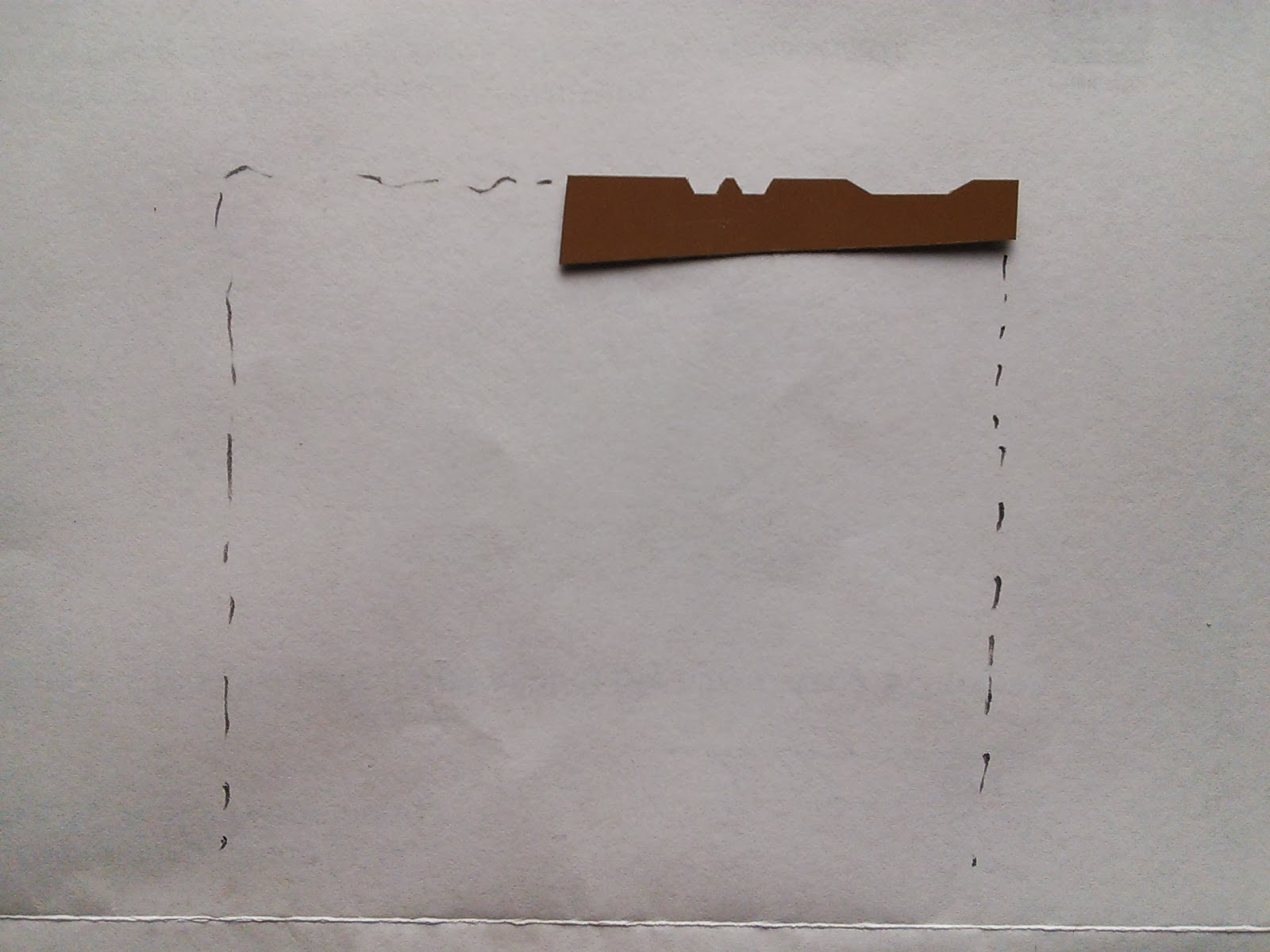

ID this notch code?

It kind of looks like both older Portra 400 NC but also one of the two Pro 100 Pxx films. Surely it is C-41 film though?

Good Afternoon, Towolf,
I've checked through some Kodak Data books from the 1970's and 1980's; nothing I found matches. The wider notch to the left doesn't really have a Kodak "look" to it.

It looks like a Kodak C-41 400 speed film. Sorry I can't give you more than that. Look into the older Portra ranges.

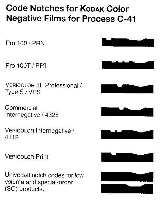

Digging the nearest is the Vericolor C41 internegative range:
4112 has the LHS correct but not the RHS which is the Special Order code, so perhaps a special order of the 4112 in some way?
http://web.archive.org/web/20030208093848/http://www.srv.net/~vail/notch.htm
Maybe the earlier SO 412 ? 412 would fit as would the SO code, that would date it pre 1978.
http://www.carlmcmillan.com/Pdf/FilmData/Vericolor Internegative.pdf

It's not dissimilar to new Portra 400, which I just bought a box of.
