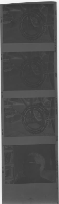

Here is a straight scan. Perhaps this is more telling.

That looks like bad base fog. Old film that wasn't stored well (or was fast film, which doesn't age well) or film that was poorly stored?

After examining my workflow, it was fogged in the changing bag - changing bag had some sort of tear in the inner liner.
New changing bag on the way.
