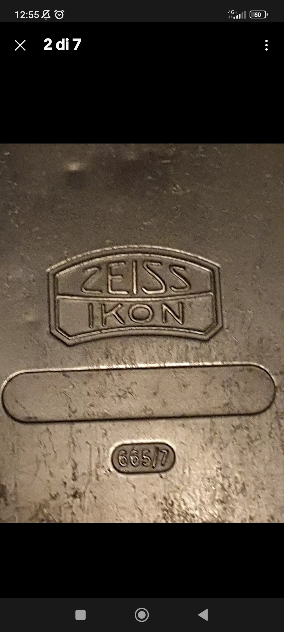

I found this one..you think It's ok? Thanks everyone
Why don’t you just check the list I posted? There you have all the information you want. Ica Sirene is not mentioned because it uses slide-in holders that will not fit your camera. What you need are 726/6 holders; the later 726/7 and earlier 727/6 may also fit. Later holders will be labeled Zeiss Ikon rather than Ica. But there is no guarantee that a 726/6 made in 1927 will fit your camera from 1922 or before – although it should in theory.

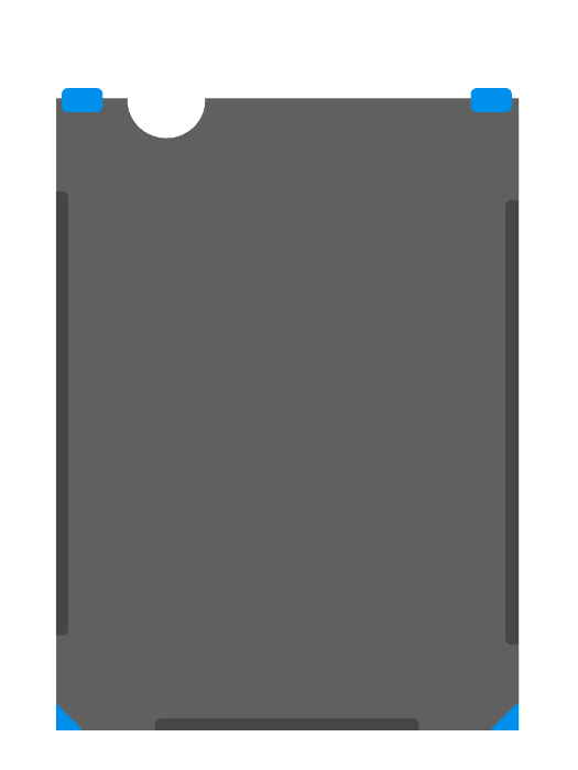

The item pictured is in fact a film sheath. And unlike plate holders, those are the same for all 9x12 plate cameras.
No, many plate holders have tabs in the corners that need to be in contact with the plate/film, so the film sheaths need to accomodate for that or the focus will be slanted. This illustration shows the tabs in the Voigtländer plate holders and what type of film sheath should be used. Many of mine are old Agfa/Orwo Filmhalter, and they work perfectly. The ICA/Zeiss Ikon 726/6 plate holders also need this type of film sheaths. Of course, that other type of film sheath can be modified with a Dremel and a file to work. You just need to remove some of the folded parts.
Different than JPD I do agree with Donald; I've many, many different plateholders, and many sheats for these (6,5x9, 9x12, 10x15, half plate, 13x18 and whole plate), and never had problems fitting the film sheats with any of the many different plateholders.
Btw you might have more luck finding 9x12 sheats on the German Ebay site (I had a link to one of them but apparently the moderaters deleted the link). Apparently we are only allowed to direct each other to links via a pm. Some argue to make sheats from plate material but if you haven't experience with that and don't have the right machining, you better don't go that route; it is also hard to find the right plate material.
