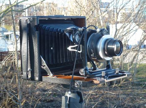

Here's another ICA with pop-on cassettes, my Triplex 410 13x18cm. From the original lens provided with it, a Tessar 210/4,5 it should be from 1914. The lens shown is a Steinheil Orthostigmat 240mm 6,8 (the Collinear type), with an adaptor for the Compound-3 from the Tessar. This specimen of the Orthostigmat is so-so.
What me would interest is what plateholders you are using with this beautiful camera.

I use the original 13x18 pop-on (anlege) cassette provided with the camera at a local dealer (but abt 25 years ago!), plus a cutfilm sheath. Yes, its a nice camera, only there's no tilts like on the Ideal.
