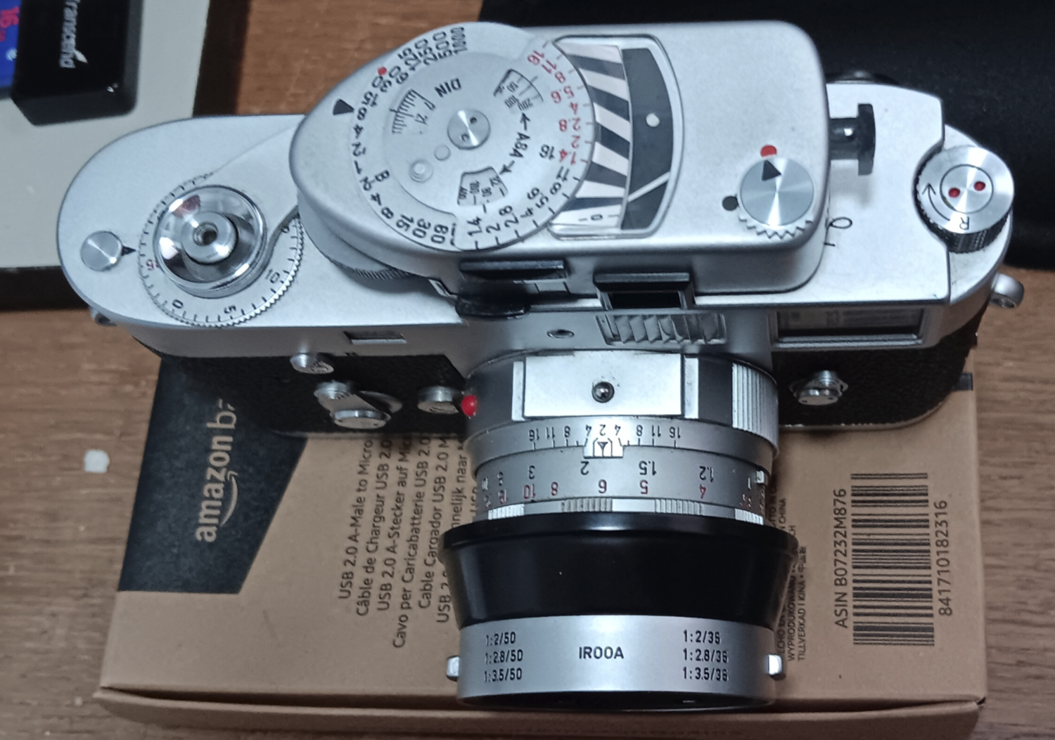

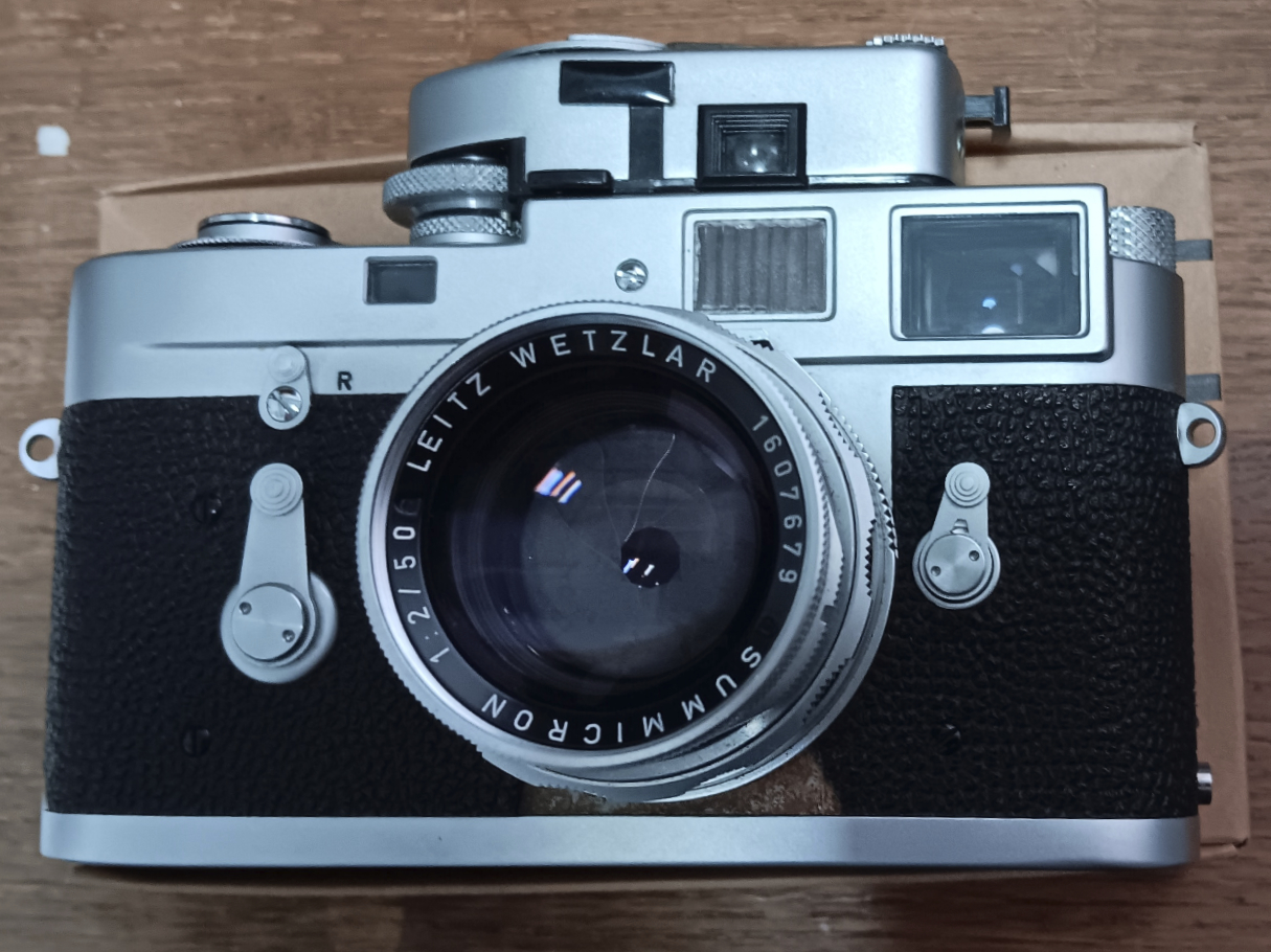

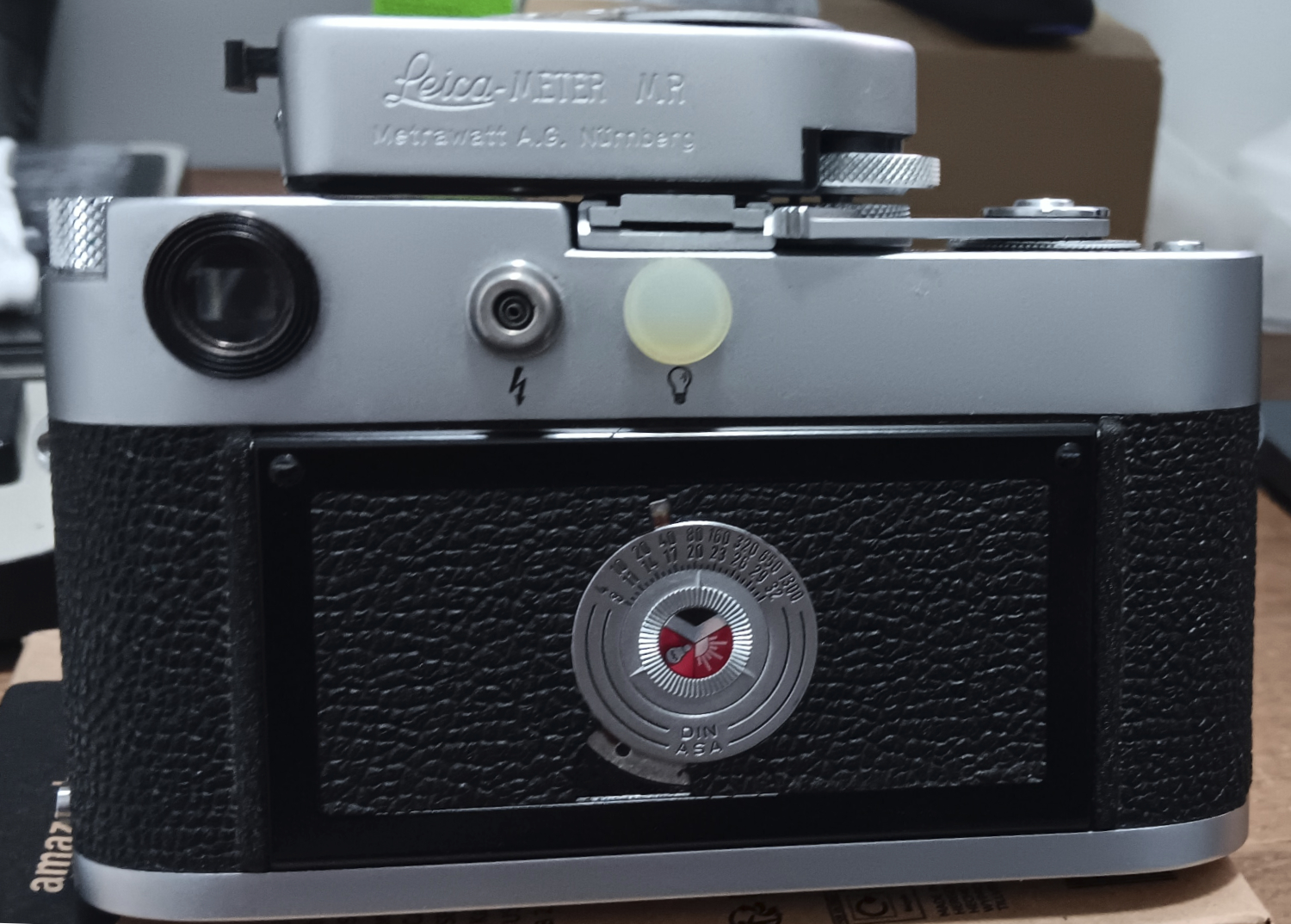

A family member gave me this Leica for Christmas! Someone had given it to him and he gave it to me to see if I could get it to work.
It seems functional but I can't ID the model as the meter seems to be stuck on the shoe mount and I can't get it off at the moment. But from looking at the lens serial number it seems to be at least from the 1950s?
Anyone know? I should look into having a CLA done here in NYC, the lens looks clean, it had a filter over it so that must have helped. Mainly curious about when you think this model was made. Thanks

The lens is the DR (dual range) Summicron.
It would have been delivered with googles that could be attached on top of the lens, in front of the rangefinder windows.
That would have allowed for close range photography.
Without them it works like a regular rigid Summicron.

Classic. Lots of people feel the M2 probably the best shooter of them all. With a rangefinder, over time, most naturally gravitate to the 35mm focal length as a standard lens, and the 35mm frames on the M2 appear just by themselves. Sunny 16 and a handheld meter is easy to learn/use. M4's actually really well made too, but I prefer the loading system and the frame lines of the M2. My only camera these days, I have five of them; and yet still only two hands.
Your pristine 50mm Summicron-DR is a superb lens. Wonderful gift! I prefer mine to all my other 50s of various brands.

Warning: keep the goggle unit. They varied over the production life of the DR, and you may have trouble finding the right replacement unit for your particular lens.
As noted, an M2. I used an M2 equipped with a 35mm Summicron lens for over 20 years. During that time, I believe I had the camera body CLA’d twice and the lens serviced once … the plastic focusing ring cracked and (I believe it was Mr. Yee) replaced it … and serviced the lens at that time.
I traveled extensively with that particular camera body; as I recall, equipped with the 35mm lens, it fit nicely in a small camera bag. Eventually “upgraded” to M4 and M4P bodies—the M4-Ps only because I preferred a native 28mm finder, and the hot-shoe made it easier to interface with “modern” camera lighting systems.

I have a question. Nippon Photo Clinic has given the camera a CLA and repaired the shutter issue but they tell me that there is some fog in the 50mm Summicron lens.
The person I spoke to advised against trying to have it cleaned saying it could make things worse. I have to say I haven't noticed but would this be something that Youxin Ye for example might be able to repair, or do these lenses often have some haze?
I did also get a Voigtlander 21mm f4 Color Skopar which I like very much.
The rigid Summicron has soft coating on the outer elements and even softer on the inside.
Many samples in circulation have micro scratches on the front from simple cleaning.
I am guessing that they estimate that haze removal may damage the inner coating.

Use a lens hood and avoid shooting directly into the sun and you probably won’t notice a difference. And try not to clean the lens if you don’t absolutely have to. Put a filter on so you don’t have to.
Yes and no. Generally when you look through the lens it's clear and if you shine a pen light you can see the fogging. But where is it? The only area that isn't touched by most techs is the cemented surface of the second lens group. The rest is cleanable but I'm not sure how deep Youxin goes with the rear groups on the DR. Generally you have to send it in if you want to know anything worthwhile.
