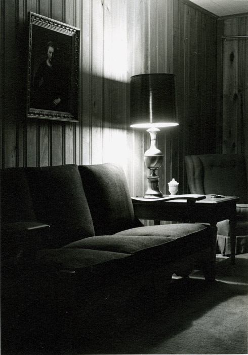

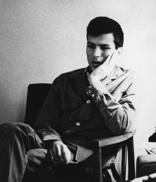

A couple of examples of vintage available-light photography, scanned from thirty year old prints, to show the qualitative similarity to the Lillian Bassman images.
The "portrait" was made on 35mm, almost certainly Tri-X, at f/2 and 1/30, in a motel room. The overall lighting was about what you would expect in a motel, and nowhere near as dramatic as it looks in the picture. Development of the film was probably in Acufine or Diafine, and the print would have been on #3 or #4 Kodabromide developed in Dektol 1:1 (it was for newspaper publication, and the darkroom was set up for minimum throughput time, but this makes for a really contrasty print).
The interior was made on 120 film, either Plus-X or Tri-X, and most likely developed in Edwal FG-7/sulfite. The print has faded (it spent most of its life in the attic of a barn in Alabama, and probably wasn't fixed all that well to start with) so some of the highlights have lost detail. In particular, the paneling directly behind the lamp probably still had detail in the original.
The nature of the exposure and processing was to put most of the shadows below threshold and into the filmbase+fog region, holding the midtones on the first reasonably straight part of the curve, and letting the highlights blow out. This requires both underexposure (the low values of a "normal" exposure become deep, featureless shadows) and high contrast (so that the desired midtones are preserved but isolated by the blown-out highlights).
