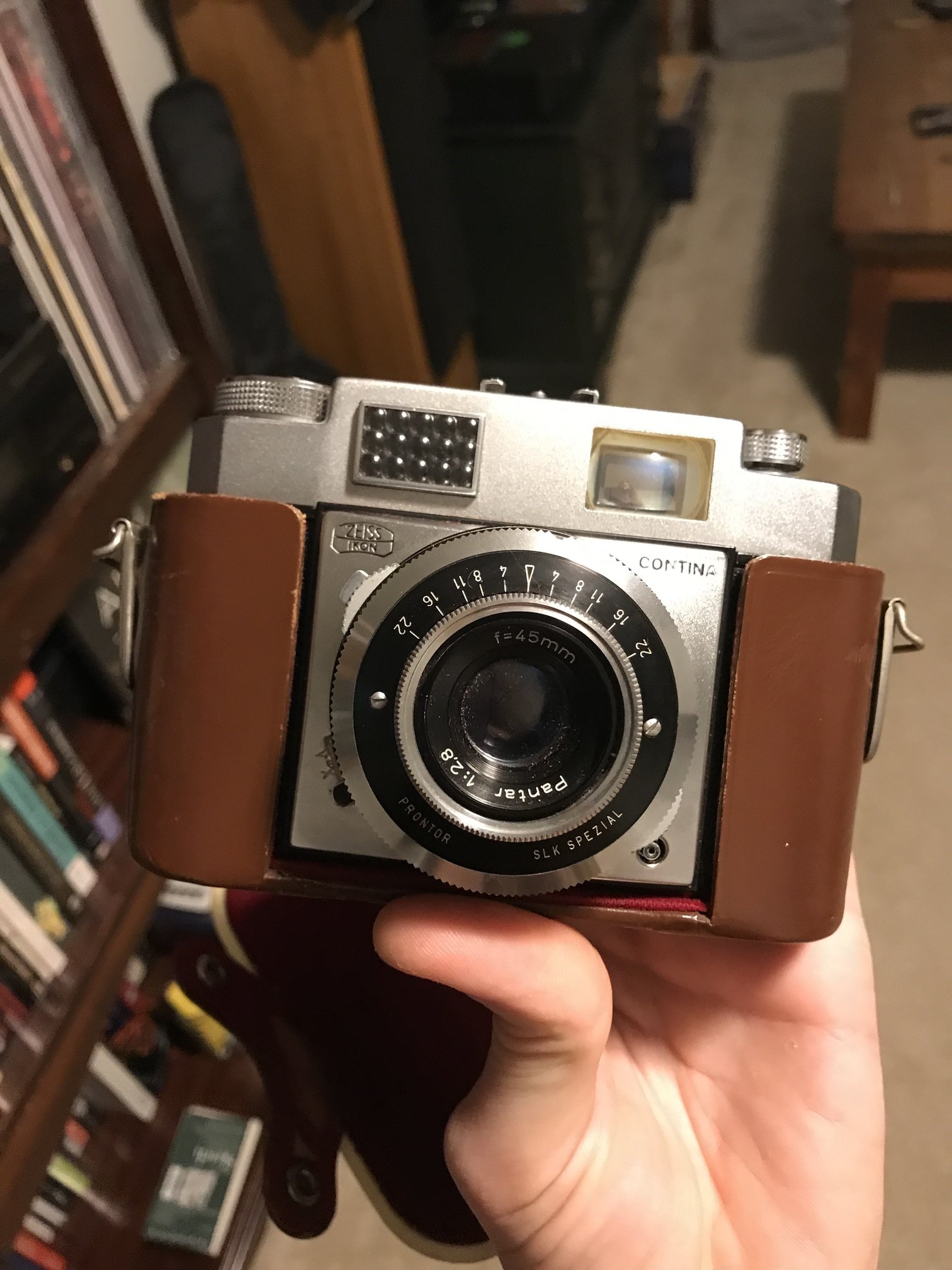

This is a shot in the dark on this forum but, I want to try my hand at camera restoration. I fix electronics for a living mainly phones and computers but I have a fascination with mechanical things like typewriters and old cameras. Was wondering if any seasoned conservators could lend a helping hand for me in the right direction for restoration resources and advice. I have tried to open up an old Contina Camera (attached). But to no avail being that the screw holding on the shutter advance lever is stuck (the screw, which is reverse threaded, is stuck in place and I cannot find a tool to get it open...). Any help is appreciated
How do you know it's reverse threaded?
